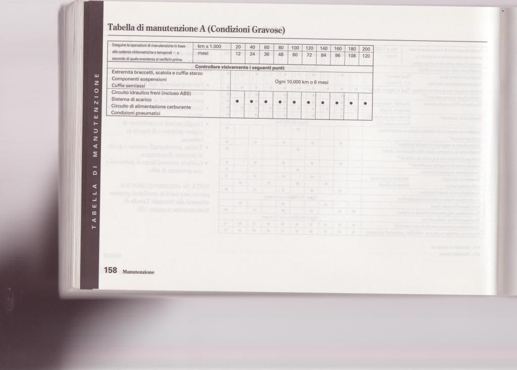

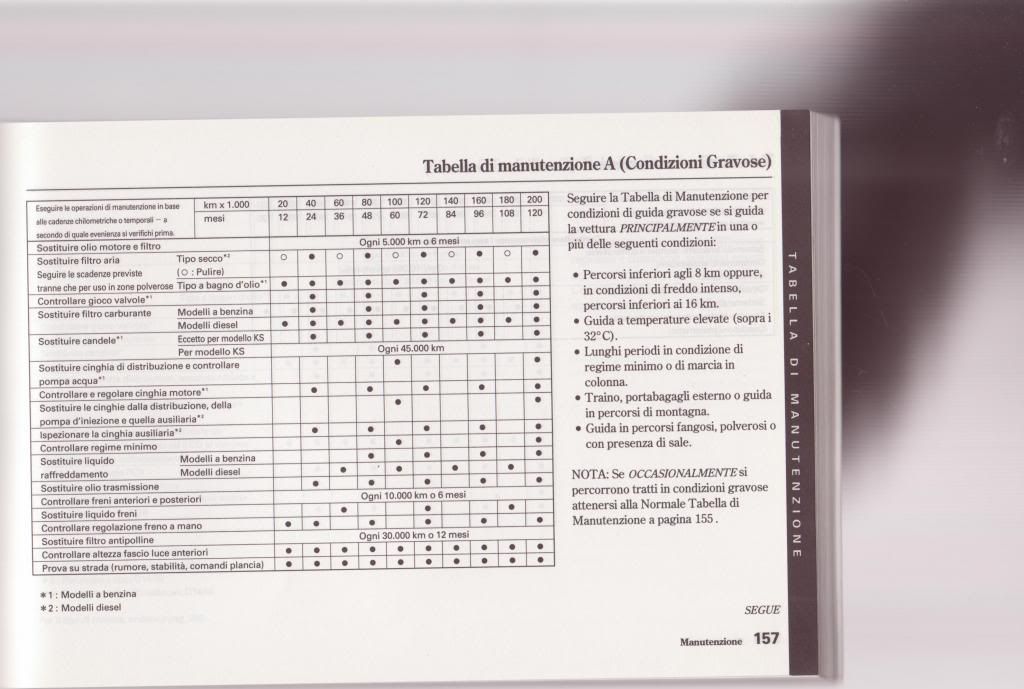

EmZvr Posted September 25, 2013 Share Posted September 25, 2013 Here are some photos from my user manual. It's in Italian because my car is from there but you can use google translate. I can't find this manual in English. Second tables (Condizioni Gravose) are for special conditions which are: • Courses less than 8 km or under conditions of extreme cold, journeys of lessthan 16 km.• High temperatures (above 32 ° C).• Long periods of idle• Towing, roof racks or mountain trails.• Muddy paths, presence of dust or salt. Quote Link to comment Share on other sites More sharing options...
