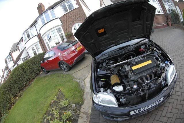

HID's were very easy to fit as they are plug and play, the only problem you might encounter is were to mount the ballast and relay.
am i the only one who mounted the hid ballasts by the horn and opposite on the other side? no need to clutter the bay when they can be nicely mounted there il see if i have a pic with them in
cars looking good, how much difference did the 4-1 mani and exhaust make to her?
here is a pic, its not very good but you can clearly see the 2 hid ballasts, one either side
any use to anyone lol

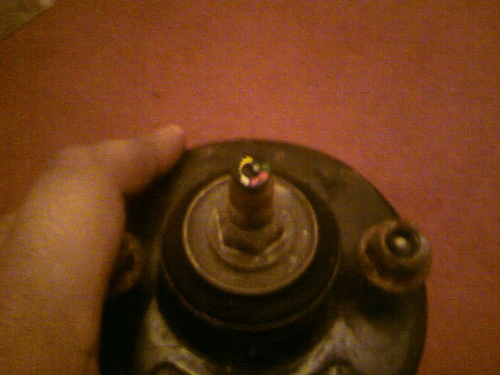

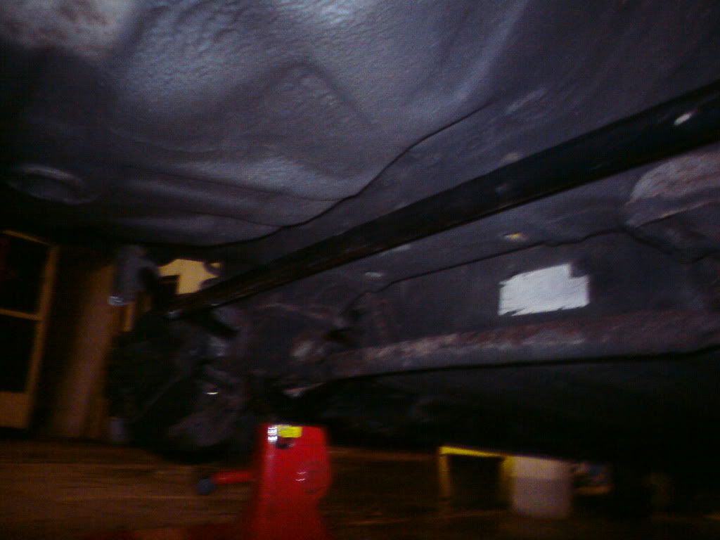

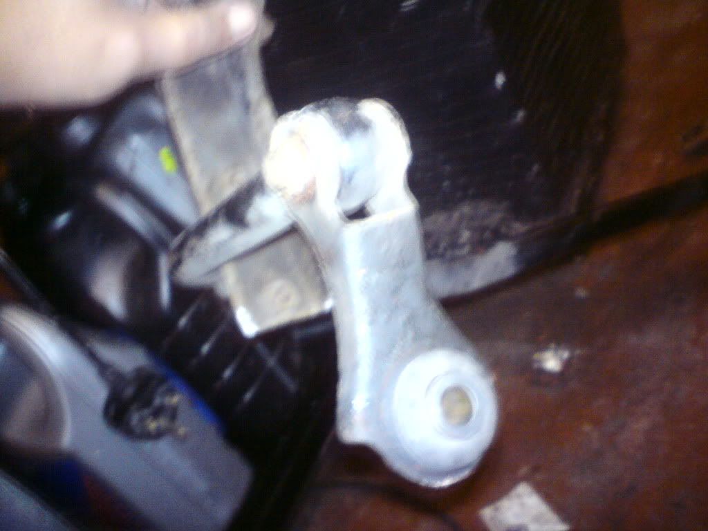

Fitted the MGZS 180 rear anti roll bar today, its a simple bolt off bolt on job. i can say the improvement is pretty good. Body roll has been reduced and turn in is alot better, the rear is better planted. it uses the same drop links as the ITR so they can be polybushed or you can get hardrace replacements. overall good mod, my old anti roll bar is up for grabs if anyone wants it, the bushes are totally shot and droplinks will need replacing.
The mb6 roll bar is the top one mg is the bottom one

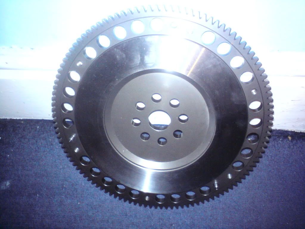

Also getting a lightweight flywheel and exedy stage 1 clutch fitted this week so hopefully this should improve engine response ,cant wait

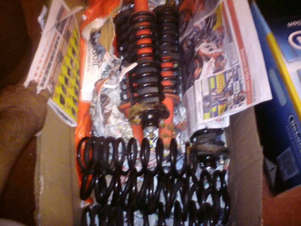

Also got my KYB adjustable dampers to go on, these will be mated to 98 spec DC2 springs which are stiffer. these should go on hopefully in the next week or so, thanks to jalesi for sorting me out with some part numbers for some new top mounts
The dc2 front spring is the one on the right, rear is the one on the left
