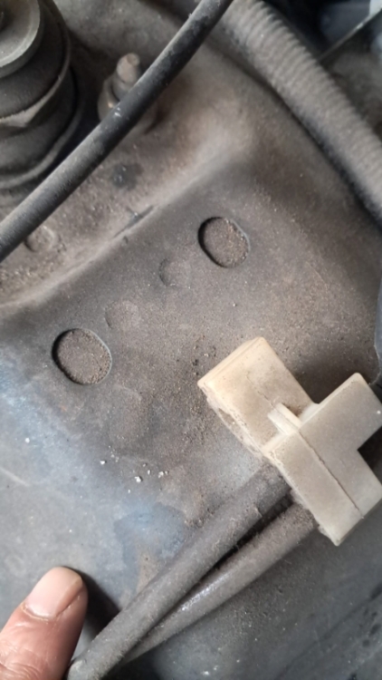

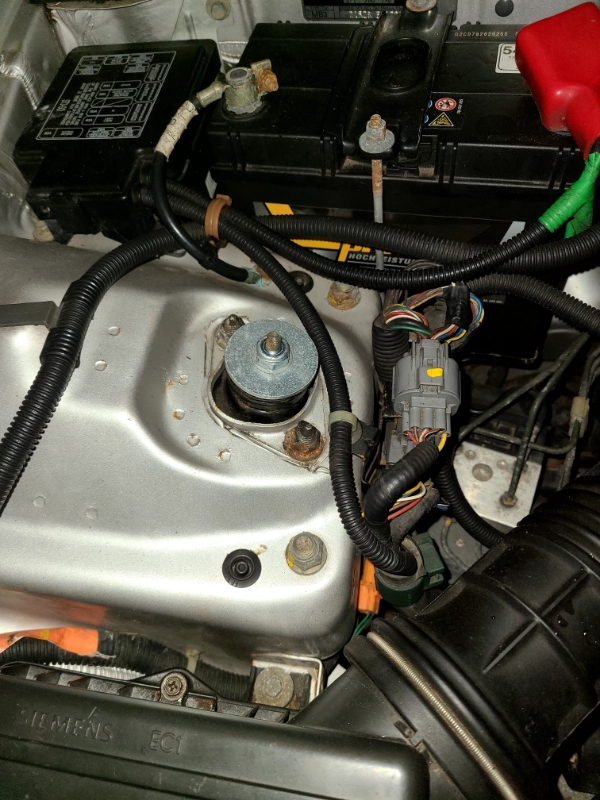

Yes, there are some marks - I guess it was to align the drill or whatever they were using in the factory if the car was to be an MB6. I'd love to know what they did - I imagine just drill and tap a hole, thread in a stud ... or maybe there was more to it than that? Maybe some extra reinforcement underneath?

Also, are you sure about the markings? I have only seen two little spots on the MB strut tower, but they are way too close together to be the ones to mount the bar on. Heres a picture of my MB3 towers:
And one from an ej, where they look alot further apart:
