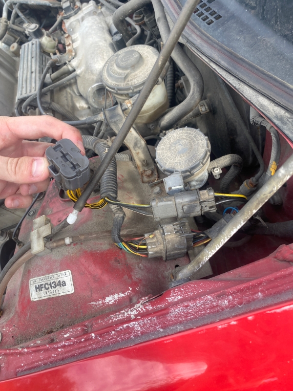

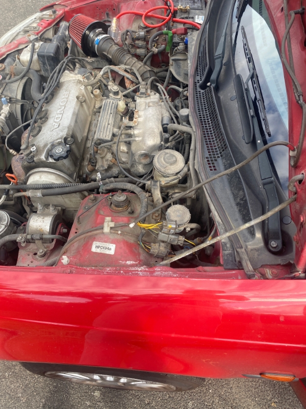

- the wire harness at the top right corner of the engine bay where the brake fluid reservoir is located has 3 connectors (male connectors i think) but only 2 of them are actually connected to something, while the third one is just hanging there next to them.
