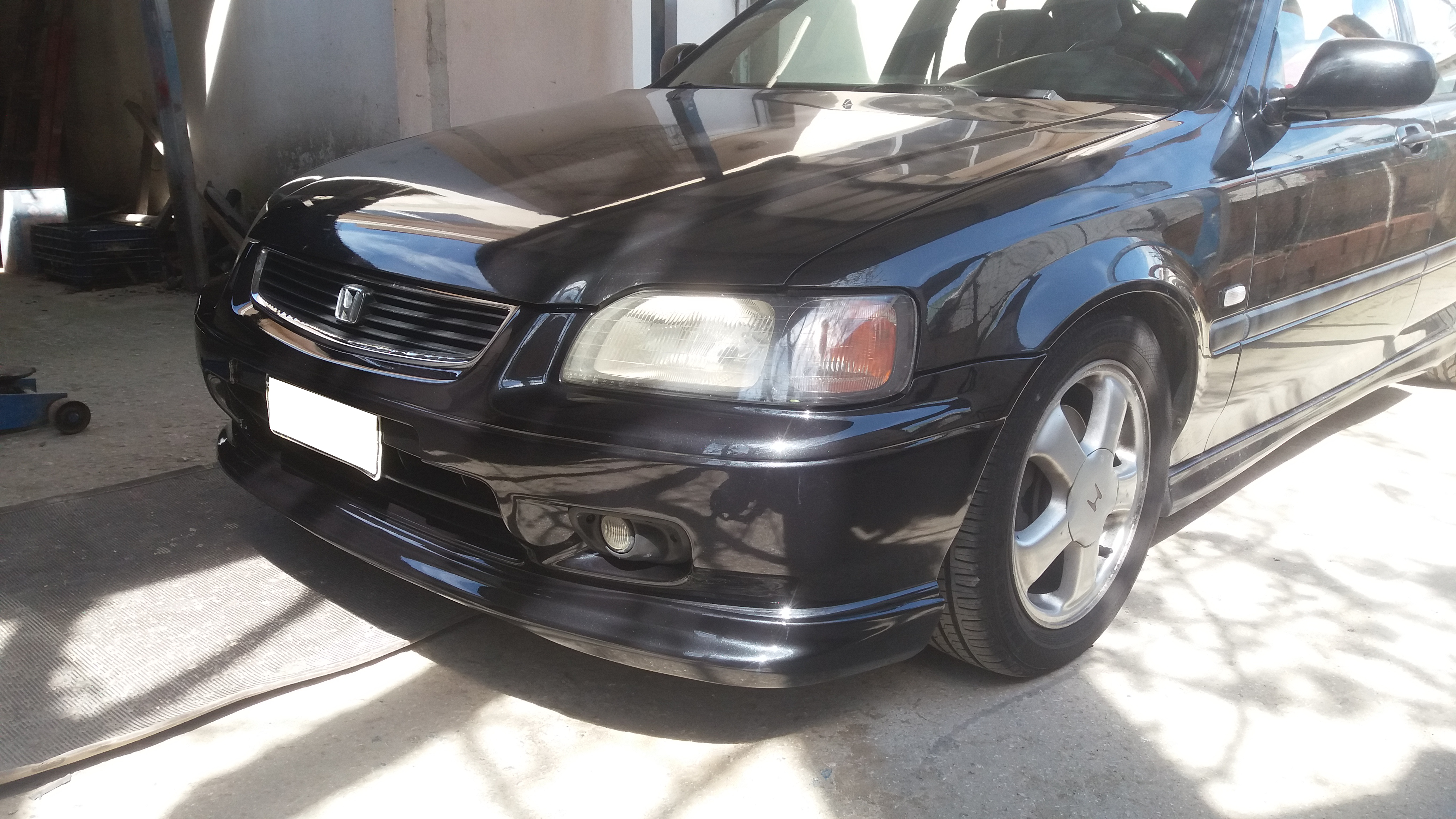

MB6 Front lip on an MB1 (and MA8-MA9) bumper.
Yes, it can be done with a little modification.
I think, my refinishing man cut a short portion at the centre of lip, then he joined the 2 pieces and he screwed them directly on the bumper without any problem.
