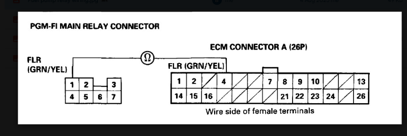

The main one you need to find is the wire for the fuel pump relay, here is the extract from the service manual

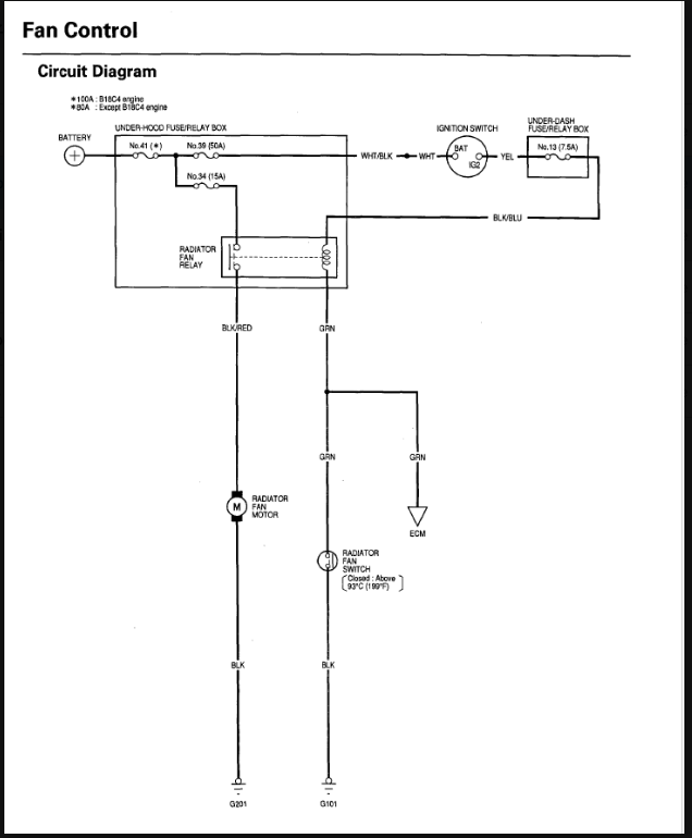

Cooling fan:
