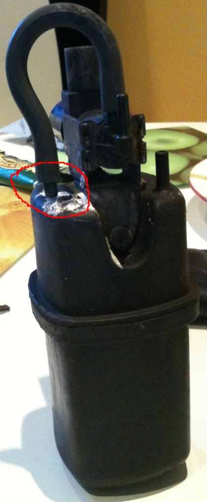

knight Posted May 27, 2011 Share Posted May 27, 2011 As you all know when i put my car on the dyno i found out my iab's were not working! today when changing all my vacuum hoses to red i may of found why there not working on the iab solenoid one of the vacuum plugs were snapped, and looks like its been repaired once already! ,,, do you guys think i'm right??? as need to hear what you guys think! Photo below show what i'm on about!,,,, Link to comment Share on other sites More sharing options...

simpo Posted May 27, 2011 Share Posted May 27, 2011 How embarassing I don't even recognise that part.dont worry mate you aint the only one reckon you might be right mate looks like it has been tampered with Link to comment Share on other sites More sharing options...
knight Posted May 27, 2011 Author Share Posted May 27, 2011 uploaded another pic above lol Link to comment Share on other sites More sharing options...
simpo Posted May 27, 2011 Share Posted May 27, 2011 isnt that pipe on the wrong lug at the top? Link to comment Share on other sites More sharing options...
weetec Posted May 27, 2011 Share Posted May 27, 2011 isnt that pipe on the wrong lug at the top?Well spotted!!!....hes got a point if you compare the 2 pics? Link to comment Share on other sites More sharing options...
johngreen537 Posted May 27, 2011 Share Posted May 27, 2011 isnt that pipe on the wrong lug at the top?Well spotted!!!....hes got a point if you compare the 2 pics?That pipes only for vacuum creation, so 'shouldn't' matter which way round they go mate, so long as they both connected Does look like a crapped solder welding attempt!Give Josh or Jonny a shout, or clean off the bodged repair and see what the real damage is! Link to comment Share on other sites More sharing options...
knight Posted May 27, 2011 Author Share Posted May 27, 2011 isnt that pipe on the wrong lug at the top?Well spotted!!!....hes got a point if you compare the 2 pics?That pipes only for vacuum creation, so 'shouldn't' matter which way round they go mate, so long as they both connected Does look like a crapped solder welding attempt!Give Josh or Jonny a shout, or clean off the bodged repair and see what the real damage is!it just snapped mate so ive cleaned it up bonded it back on, that would off stopped the iab's engaging cause all the vacuum would off been lost?? won't it?? i hope so lol! we will see tomarrow! Link to comment Share on other sites More sharing options...
johngreen537 Posted May 27, 2011 Share Posted May 27, 2011 Yeah mate, it'll need to be air tight at least, then it'll need to be strong enough to cope with the pressure of the vac.Epoxy or equivalent should work though, or chemical metal! Link to comment Share on other sites More sharing options...
