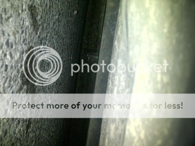

shamz Posted November 24, 2011 Author Share Posted November 24, 2011 Not the best of pics but I work during the day so hard to get day pics:Can you see how close the rear end of the mid is to the floor? You can even see the fresh scrape marks lol. Link to comment Share on other sites More sharing options...
james Posted November 26, 2011 Share Posted November 26, 2011 that pipe should be up in the tunnel not hanging like that Link to comment Share on other sites More sharing options...
shamz Posted November 27, 2011 Author Share Posted November 27, 2011 That's the problem I'm facing. If I put it in the tunnel the mid touches the gear shifter. The pipes not even rubbing the humpls believe it or not its the mid Link to comment Share on other sites More sharing options...

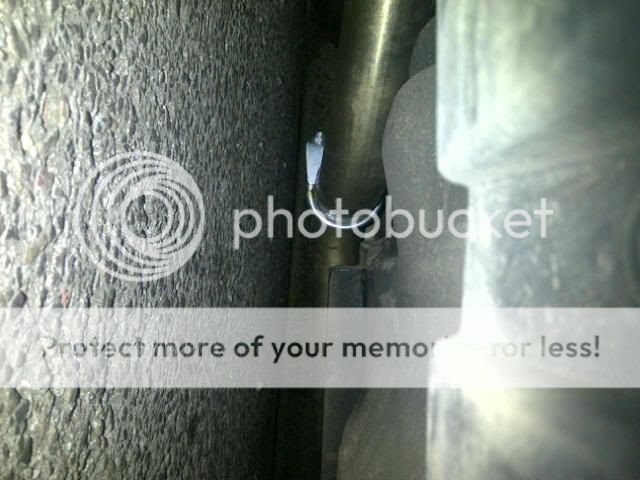

shamz Posted November 27, 2011 Author Share Posted November 27, 2011 Basically from it came in four pieces. A pipe(b pipe) which bolts onto the cat and then clamps on to the mid. Then the mid. Then another pipe which you can see in the second pic goes from the mid to the back box and then the backbox itself. We tried using shorter rubber mounts to raise it but anymore and it touches the shifter. Link to comment Share on other sites More sharing options...
shamz Posted November 28, 2011 Author Share Posted November 28, 2011 Cable ties seem to have done the trick for now lol Link to comment Share on other sites More sharing options...
