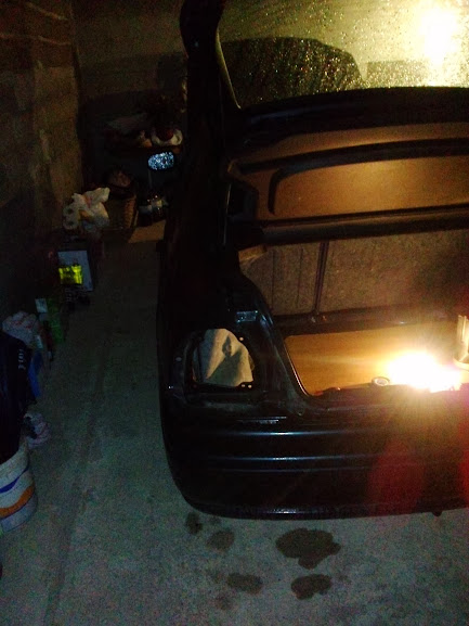

Today i replace my tail lights for the new ones that came in this week.
In here i´m going to show you how to change yours ;)
1-you have to unplug the battery because of the light on the trunk .
2-Open the trunk.
3-Discover your new tail lights inside :D
4-Take out the floor carpet of the trunk.
5-Then you have to remove this pin that holds the side carpet.
6-Pull the pin with a screwdriver.
7-Remove the carpet on the bottom of the trunk.
8-Take it aside.
9-Remove those bulbs and connector out this way.
10-Then i noticed this that there is a cap in the way and i post it in the morning and i have to drill it. (here is the post link):
http://civic5.com/forum/index.php?/topic/8021-help-with-a-tail-light-cap/#entry164969
11-Then you have to undo the 4 screws that holds the tail light in place.
12-Then you just have to pull from the outside and it comes out easily.
13- Then you just have to put in the new tail light and do the whole process on reverse.
14-Make the same process on the other side and the result will be something like this;)
I hope you all enjoy the tutorial and leave a reply :D
