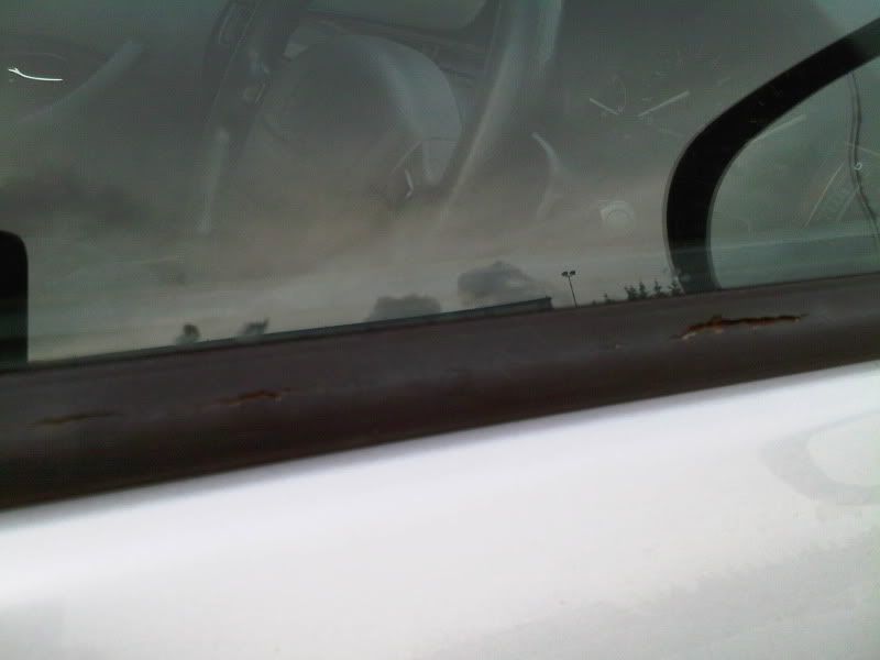

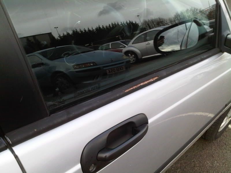

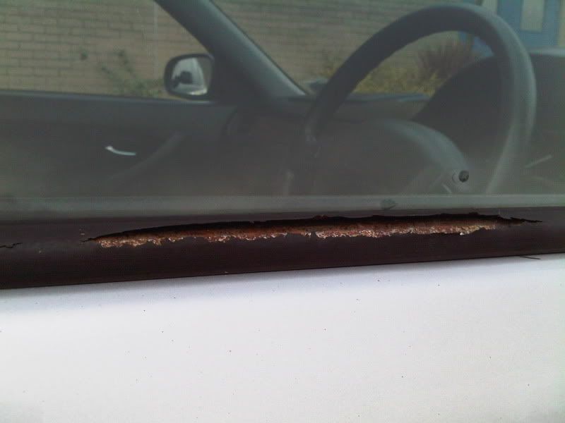

knightmaric Posted March 21, 2010 Share Posted March 21, 2010 Hey all,I've got 3 pictures of the black bar that's inbetween the door and the window on my MB2.Basically the black seems to be peeling on the drivers side and cracking, and the metal beneath is showing signs of rust because of this.It's just getting worse each day.How do I take the bar off of the door?I've not been able to figure it out properly because i've not had a lot of time to myself lately.Because as soon as I know how i'll get a new/used one and replace it.Here are some pics to show what it's like. Link to comment Share on other sites More sharing options...
civicturbo79 Posted March 21, 2010 Share Posted March 21, 2010 They are hard to get off mate and usually end up breaking which is ok for the old units but it does mean 2nd hand ones are hard to find . plus new ones are £40 each . The way to get them off is wind the window down and roll the moulding towards you that will get all the clips off bar the one on the far left you will need to put a plastic filler slide each side of that clip and pust them together and it should come off . Rich. Link to comment Share on other sites More sharing options...
knightmaric Posted March 21, 2010 Author Share Posted March 21, 2010 I'll risk breaking the scrapyard ones if they cost that much xDThanks for the guide on how to do it =]Will give it a shot when I can find a doner car.Just wondering but you said to roll the mouldings back to show the clips, how to you get the actual clip off?Do you just grab and pull the bar itself? Or get a set of pliars in there if they'll fit?Thanks again =] Link to comment Share on other sites More sharing options...
civicturbo79 Posted March 21, 2010 Share Posted March 21, 2010 When you roll the mounlding towards you the clips will let go of the inside of the door frame but you will have the 1 clip on the left hand side as its a differant type of clip . Rich. Link to comment Share on other sites More sharing options...
