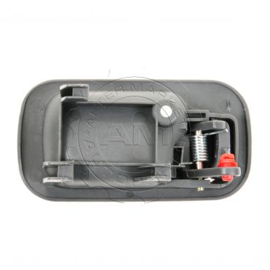

Krzys Posted November 27, 2015 Share Posted November 27, 2015 Just one thing to note, the door handle cable is clipped on to the door handle itself, either green or white, you need to unclip it from the metal rod and then the hook will lift out. This is on the back of the door handles by the way. People tend to snap those but they're easy to do properly if you know about it. It's the red part on the above picture as an example. Hope this helps! Quote Link to comment Share on other sites More sharing options...
