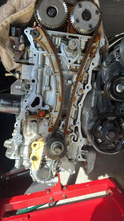

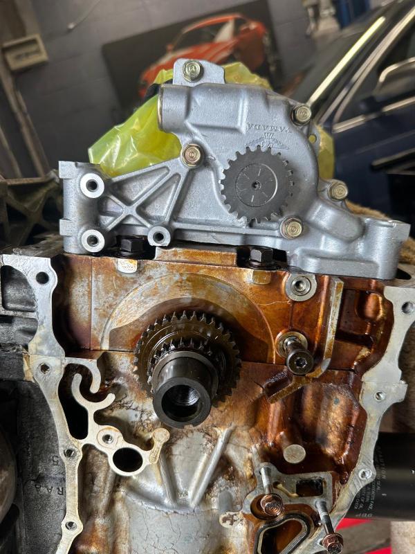

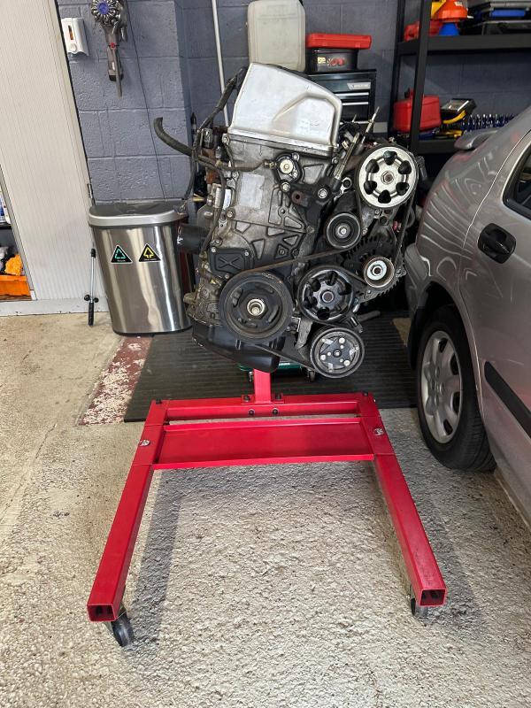

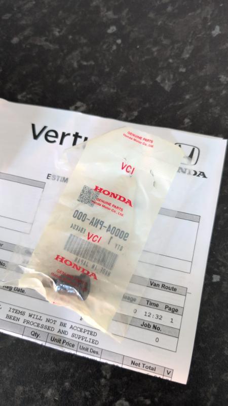

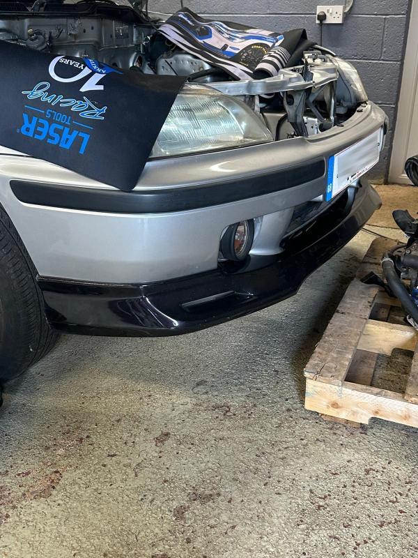

btjtaylor Posted May 28 Author Share Posted May 28 Haven't had much time recently myself to work on the MB but my father in law has been cracking on with some jobs in my absence K24 mounted up to the engine stand to begin work K20 oil pump cut and fitted. There is a lot of dried up oil "varnish" within the engine so we may run some engine flush and change the oil again once it's running. RBC cam gear fitted (50 degree VTC) - Chains and guides refitted, timing checked. As the eagle eyed may be able to spot - unfortunately one of the oil pump guide bolts rounded off on removal... so after one trip to the local Honda dealer and £7.25 lighter i'm the proud owner of a new guide bolt! (It's crazy how overpriced these small parts are in the UK. They're £1.64 in Japan but of course that comes with a 2 week wait...) Front VTI-S lip test fit - needs painting of course. Currently pondering what to do with the fog lights as they are a bit of an eyesore - one of them has rusted inside and it looks like there's a surround missing. I might just get the blanks and delete them, weight saving (!). 2 Quote Link to comment Share on other sites More sharing options...
dr_broon Posted May 29 Share Posted May 29 We get properly ripped off for parts. It always amazes me looking at honda parts from America compared to here.. The dollar price is normally less than the price on pounds, and then you've got the exchange rate to factor in... It's mad. I got some gearbox bits for a fraction of the UK price even with delivery and tax. For the fog lights, a while ago someone fitted these which are supposed to be a good match for the rare big fog lights. https://ebay.us/m/3mKXkv I've had them in my watched items list since, but haven't got them myself as I fitted some big ones from a honda stream. Quote Link to comment Share on other sites More sharing options...
dan1 Posted May 29 Share Posted May 29 2 hours ago, dr_broon said: For the fog lights, a while ago someone fitted these which are supposed to be a good match for the rare big fog lights. https://ebay.us/m/3mKXkv I've had them in my watched items list since, but haven't got them myself as I fitted some big ones from a honda stream. Can confirm these are direct replacement to the existing big fogs. You might need to swap the plug over however. If I remember correctly the front seal wasn't great so I used a big o-ring between the glass and the front screw on cap piece to keep the water out 2 Quote Link to comment Share on other sites More sharing options...

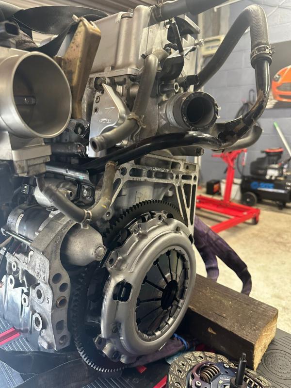

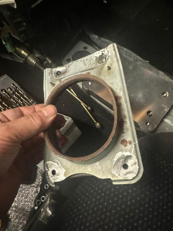

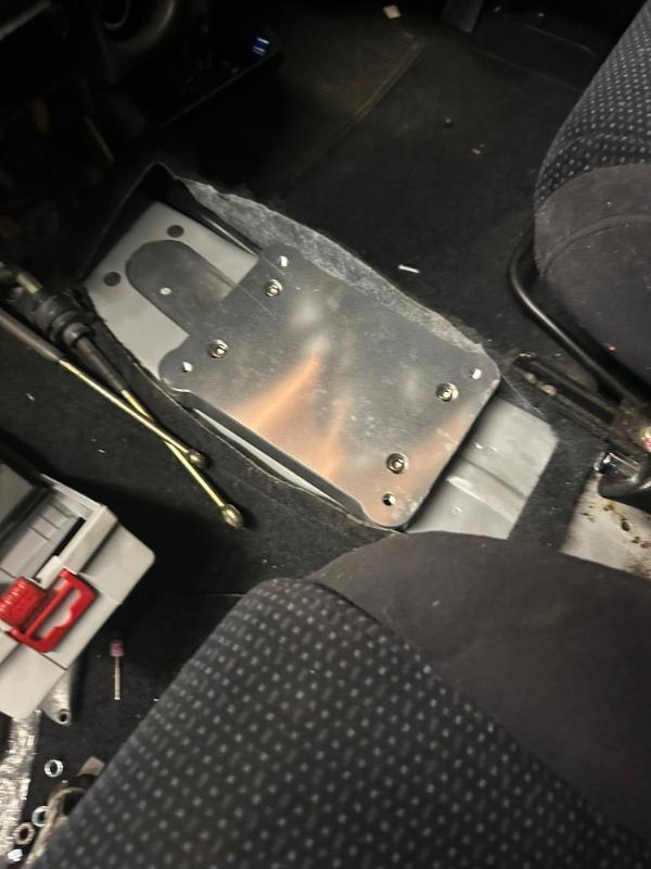

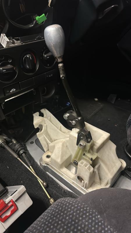

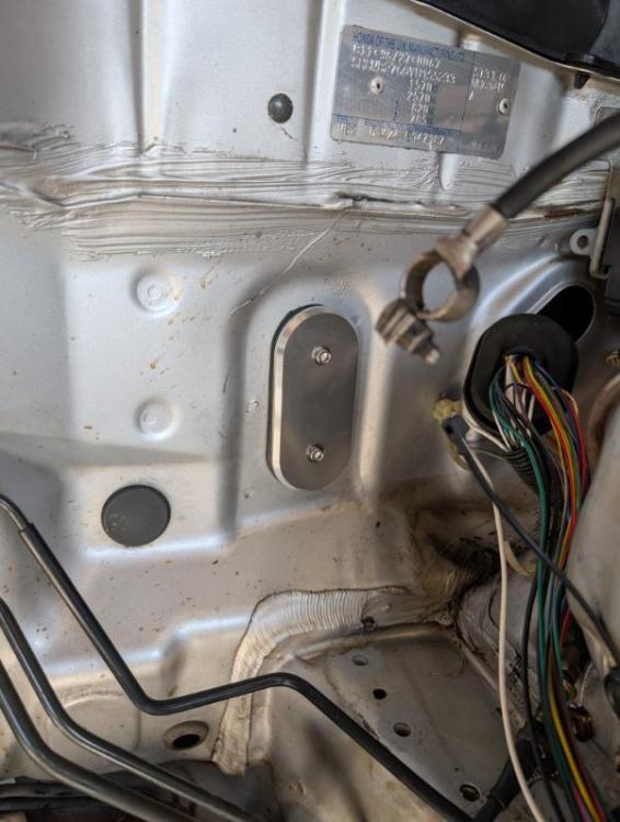

btjtaylor Posted June 9 Author Share Posted June 9 Thanks for the update on the fogs - I managed to get a set of good condition blanking plates so i've removed the fairly rotten big fogs for now but I may reinstate them later. Left the connectors tied up behind. A bit more progress on the K-swap side of things: Drilled a couple of holes in the firewall just under the heater outlet to allow for the shifter cables to pass through (no photo, oops) Got hold of a billet shifter plate designed for an EG but it was sitting too proud of the tunnel so drilled out the fasteners for the shifter base plate and removed it DC5 shifter mocked up - was worried that it would be too close to the dashboard but it seems to just about be ok - the shifter box came with a short shifter already fitted which should help things Clutch and flywheel test fit - just waiting for various missing bolts to arrive from Japan before buttoning it all up. Toyed with the idea of getting an uprated clutch but we've gone with Exedy OEM EP3 clutch for now as it's many times cheaper than an uprated one (£126 vs ~£400) and I reckon it'll be OK for NA power levels. Any future plans to boost the car would require an LSD as well as a clutch upgrade anyway! Flywheel is a Competition Clutch 3.9kg 3 Quote Link to comment Share on other sites More sharing options...

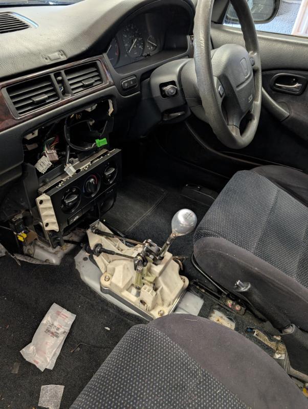

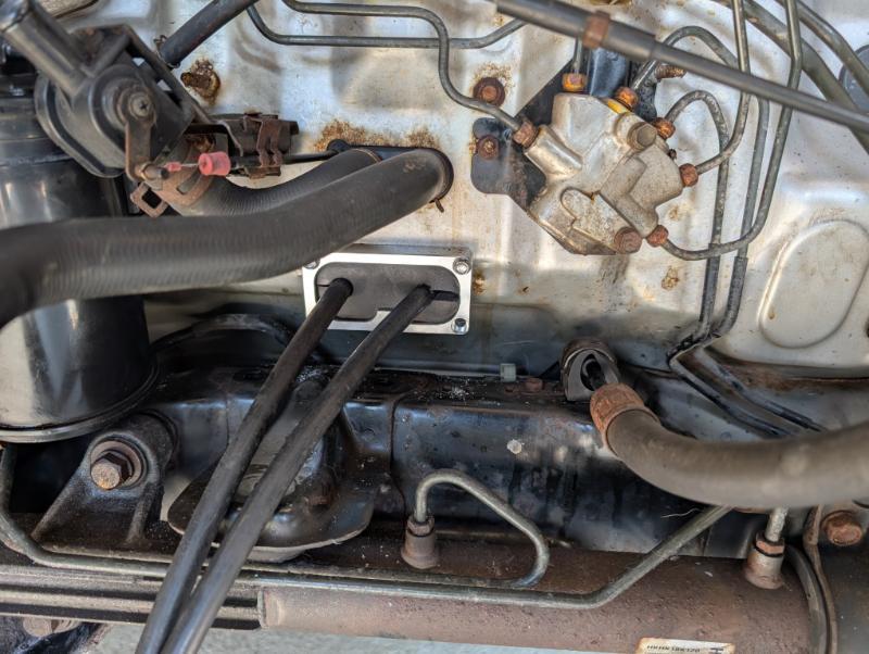

btjtaylor Posted June 16 Author Share Posted June 16 Shifter mounted properly in car and cables routed. Some hacking up of the console will obviously be required but I should be able to have all the dashboard etc back in Shifter cable plate in place - still needs a bit of work to get the other two bolts mounted and enlarge the hole in the grommet slightly. It's sitting at a less than ideal angle but it was the best placing we could come up with - the DC5 shifter cables we're using are on the shorter side Air con delete block off plate fitted so no huge hole directly into the cabin! 2 Quote Link to comment Share on other sites More sharing options...
dan1 Posted June 17 Share Posted June 17 Looks mega! That ac delete plate looks alot smarter than the bung I 3d printed haha Quote Link to comment Share on other sites More sharing options...
