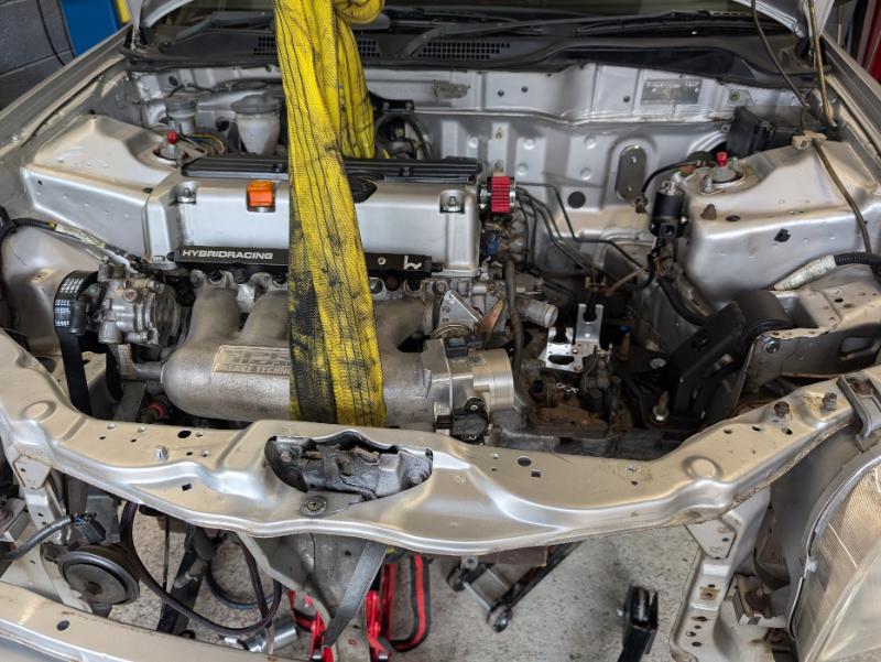

Managed to do the last few jobs to get the engine ready to install.

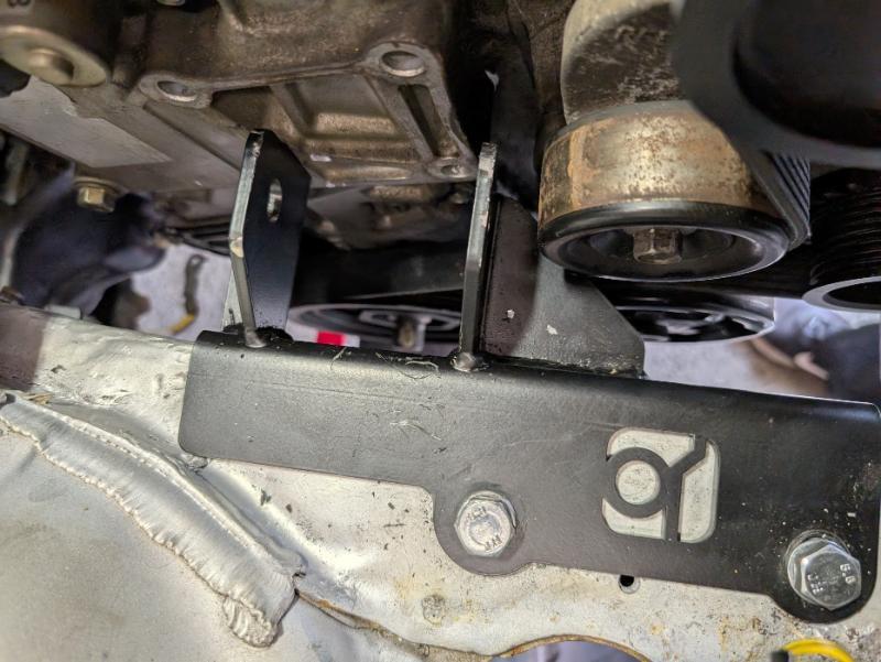

However, try as we might we just could not get the engine to go into the mounts, despite everything going ok. After about 4 hours of swearing, hoisting the engine up and down, and tilting it evey which way we could think of, it would just not go into the mounts and the aux belt and pulleys kept getting snagged
After giving up and looking on the internet for advice I found that the right hand (drivers side) engine mount supplied was the wrong one.
Our looks like this with the "cradle" coming out the side of the mount

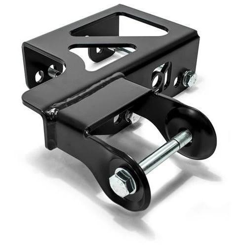

But it's supposed to look like this with the cradle on top!
Because the mount fits to the car and the rest of the kit is correct we didn't realise for an embarassingly long time.
Never mind ... I will complain and hope to get supplied the correct part as soon as possible
For now this is as far as we've got ...
So close but yet so far ...

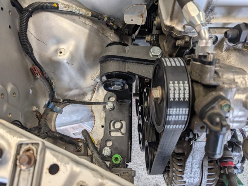

After nearly a month delay with far too many emails back and forth we finally got hold of the replacement engine mount bracket from Innovative Mounts and the engine is now finally bolted in!
Got a few other bits fitted after this photo like the radiator, hoses, and fan, and then started to work on some of the plumbing like the clutch line. Getting exciting now - to be continued!
Big milestone achieved there bud.
Looks weird the engine being so the way across to the driver side with space at the other end.. So used to it being the other way.
Exciting times 😎

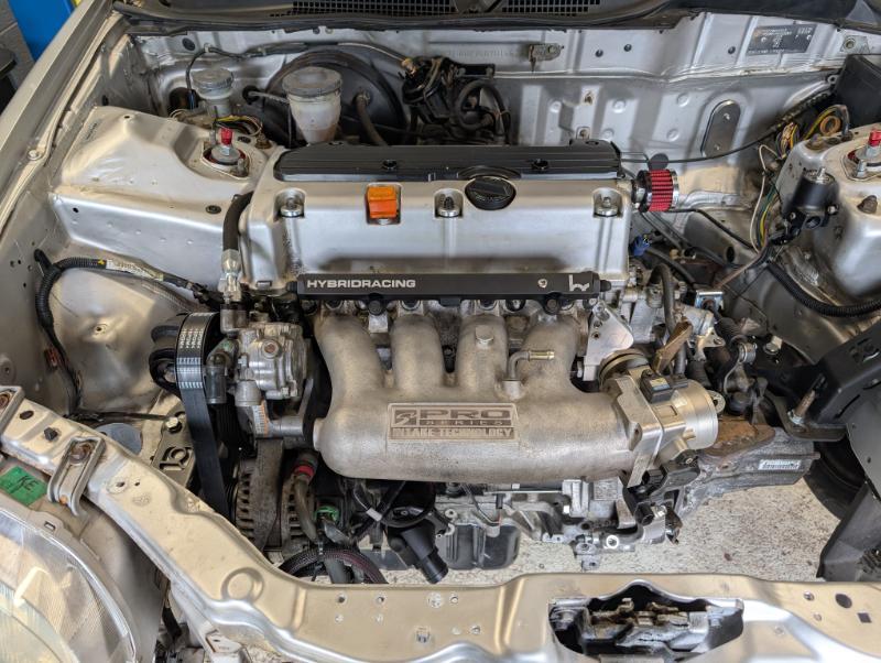

Another good day of progress today
Radiator in
Hybrid Racing power steering kit in and connected up
Fuel lines connected
Radiator hoses and heater hoses connected
Started to wire in the engine harness - lots of mess and unnecessary wires to tidy up but I'm going to wait to hear the engine  run first before I go mad chopping out something that we might need!
I reckon another solid day on it next weekend and we might be able to hear it run...

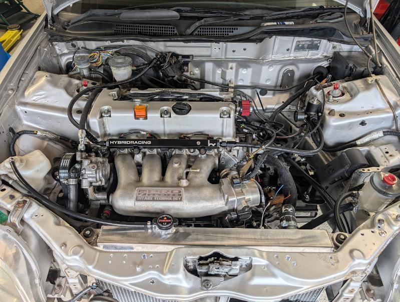

Big moment this morning after a few days of battling with electrical problems we finally got the car started!
It sounds terrible as theres no exhaust, various vacuum leaks and things not plugged in, but feels great to get to this point, absolutely buzzing that we can start to tidy everything up now and get it driving
To be continued...

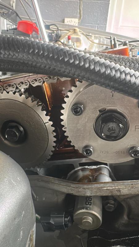

Engine wasn't running great with a lumpy idle (almost like muscle car sound!). At first I just put it down to the open header being super loud but we started to get timing codes logged on my ODB reader (p0341).
I checked a few easy things like the wiring to the sensors etc but unfortunately after removing the cam cover we found the timing is out, most likely the chain was stretched and we didn't realise (even though we were able to set it right, which I can't quite get my head around)
Moral of the story is, don't re use the existing chain even if you think its ok
New chain, tensioner and guides ordered...

According to Google the amount it's stretched probably isn't enough for mr valve to meet mr piston so I think weve got away with it.
Every cloud has a silver lining at least, it's given me an opportunity to change a few oil seals in the engine and sort out a few hoses that were bodged together quickly from the junk pile!
