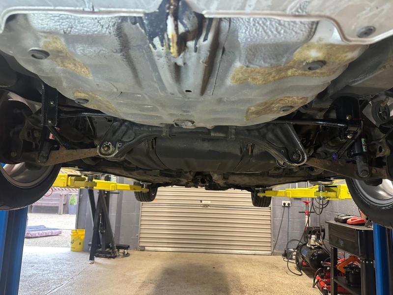

btjtaylor Posted October 14, 2025 Author Share Posted October 14, 2025 Had a few pics from my father in law today who has been doing a few bits on the car Anti roll bar is on - there was a bit of confusion because whilst the brackets themselves are shaped symmetrically they fit on the car asymmetrically. If you put the brackets on the same on each side the ARB sits at a strange angle and the drop links don't line up (Once its completely fitted I'll probably make a post listing out all the parts you need as it's not particularly well documented online) After a bit of back and forth I did eventually find a photo from an unrelated MG forum thread that cleared up the matter. Here's how it looks now (notice how the passenger side is towards the rear of the car and the drivers side is toward the front. Maybe this is common knowledge but it was not obvious to me! Next job - fit hardrace lower control arms as the poverty spec MB lower arms are missing the drop link attachment point (plus the bushes are shot anyway) 1 Quote Link to comment Share on other sites More sharing options...

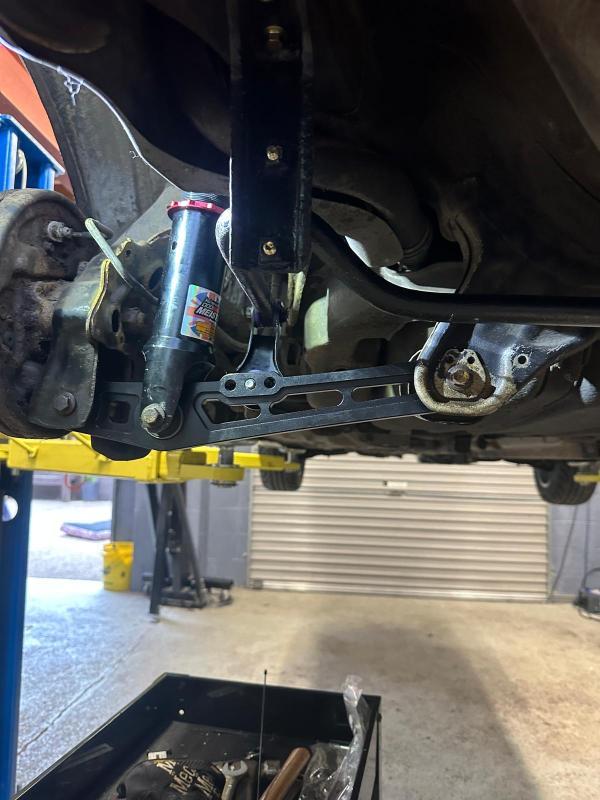

btjtaylor Posted October 16, 2025 Author Share Posted October 16, 2025 Hardrace rear lower control arms fitted and connected to the new ARB drop links - looking fresh! Although I do feel that the rear drums are shaming me! (They're on the very long list..) Next job for the weekend, drop the fuel tank to put a walbro in. (Not looking forward to this but then it's done). No idea why the pump couldn't be accessible through the cabin on these cars but never mind!! Quote Link to comment Share on other sites More sharing options...

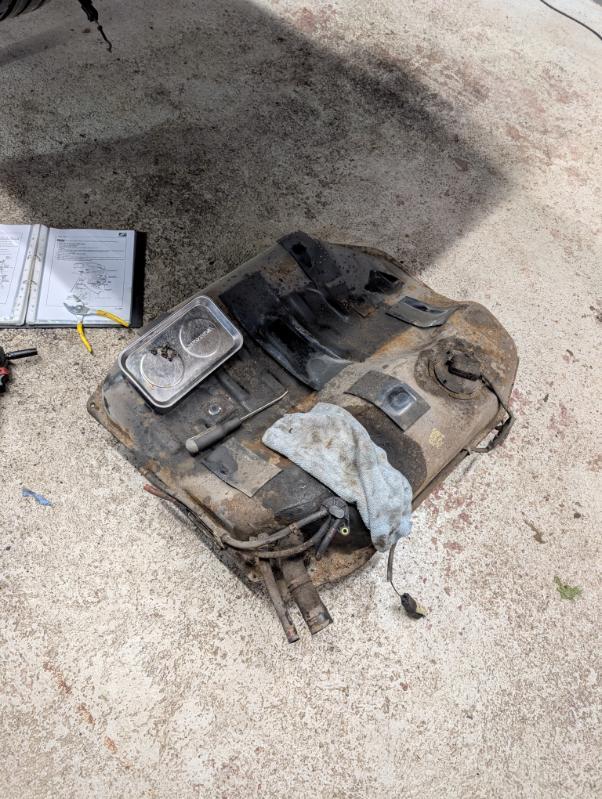

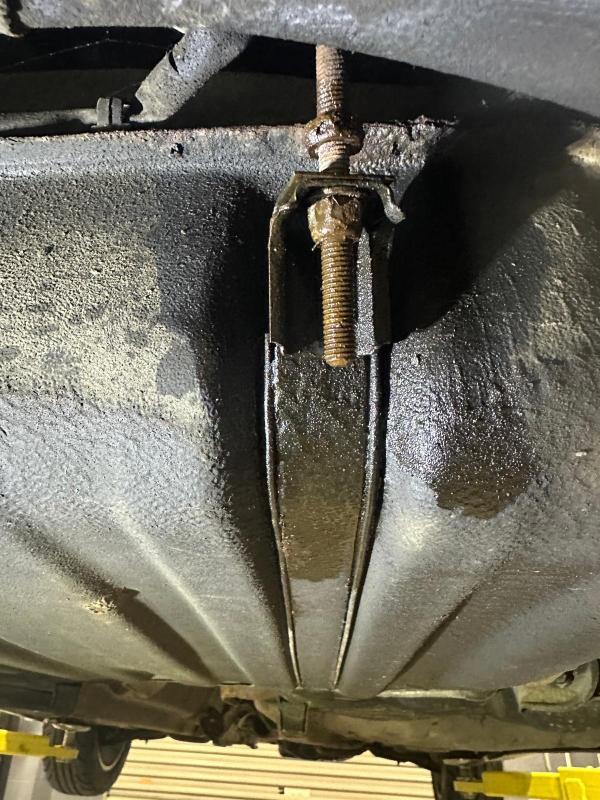

btjtaylor Posted October 23, 2025 Author Share Posted October 23, 2025 Managed to get the tank out and in at the weekend with surprisingly little drama. Plenty of WD40 and the impact gun on the nuts got them going. From there I just followed the instructions from the service manual without any major difficulties. Tank was very dirty with some surface rust but under all the grot it was in perfectly good condition. Gave it a quick clean off with some WD40 and a wire brush. I am lucky to have access to a 2 post lift.. I can't imagine trying to do this on axle stands. I the fitted the following walbro 255LPH fuel pump that I purchased from Tegiwa https://www.tegiwa.com/products/walbro-255-fuel-pump-kit-honda-civic-eg-ek-integra-dc2 Forgot to take photos of the important bit, the pump... But in summary, it's almost a "plug and play" swap - the electrical connector was the same, only thing I really had to do was trim a little bit off the rubber hose that fed the pump as the body of the walbro is longer. I also opted to use the original filter "bag" from the stock pump as it was a different size/shape to the new one that came with the walbro and I read an old post on here from someone saying they fitted one with the new bag and the car ran out of fuel at 1/4 tank so I didn't want to risk it! Tank reinstalled and the car fired right up with no signs of leaks, glad that job is off the list. It's still a complete mystery to me why there is no access hole especially as there's a hole on the other side to get to the level sender! I was almost tempted to break out the hole saw and make one.. Weve currently got an issue with the engine overheating, I am hoping it's just an air lock (I've heard k24 swaps can be notorious for this as the radiator fill point is lower than a lot of other components as the engine sits a bit higher than the d series would've done), and we have some funky shape hoses. I've tried massaging the hoses and jacking the front of the car in the air to no avail. I've bought cheap a vacuum coolant filling kit that you hook up to an air compressor from Amazon for £40 so will see how I get on with that... Fingers crossed that sorts it. 1 Quote Link to comment Share on other sites More sharing options...
