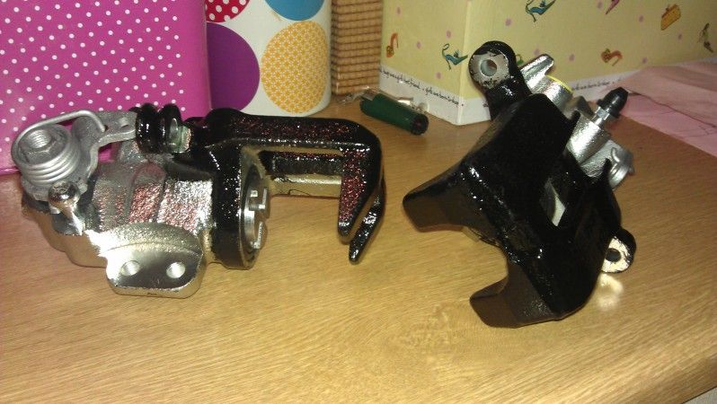

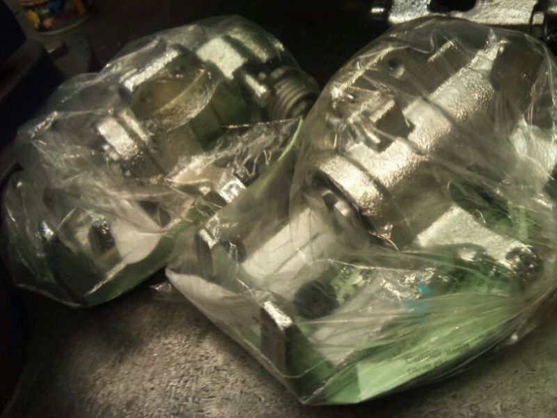

KiNK43 Posted March 23, 2012 Author Share Posted March 23, 2012 she has now had her 3k mile service! in the pitch black last night.oil everywhere when i looked today.i have received my new calipers today and i have my black caliper paint. so thats a job for tomorow. get the new discs and pads on too.hope the weather hold out now for sunday. for gearbox number 5! oh right! Link to comment Share on other sites More sharing options...

KiNK43 Posted March 24, 2012 Author Share Posted March 24, 2012 i will do, need to get some more cable now though! hard stuff to get unless you want a 100 meter reel at about a kazillion pounds.i have a friend who works for a company that solely refurbs calipers. they had these sat on a shelf so i got a very good price indeed!ready to go on tomorow. first time ive done rear calipers so should be interesting. Link to comment Share on other sites More sharing options...

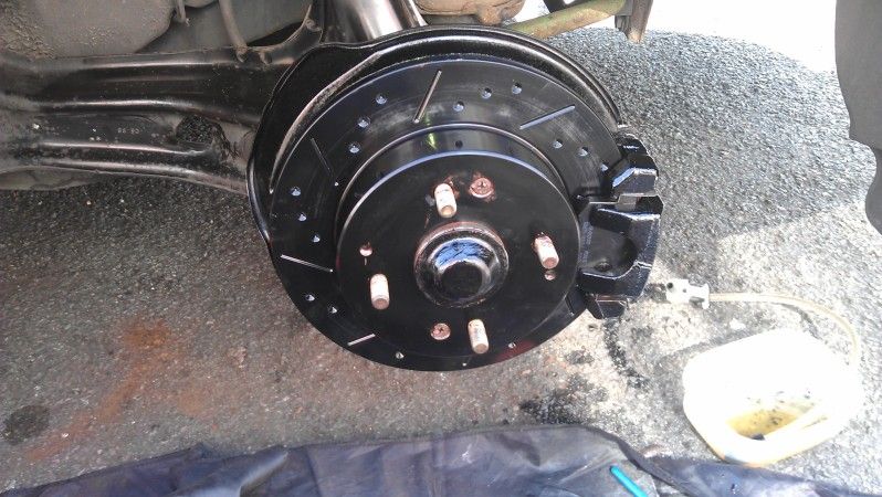

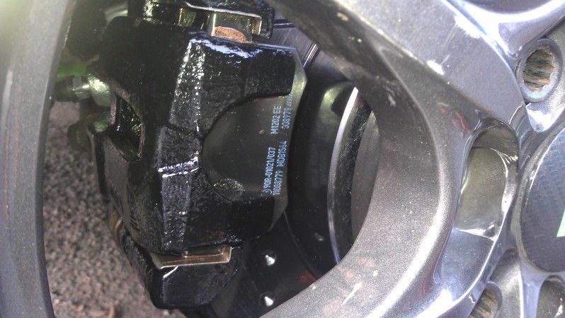

KiNK43 Posted March 24, 2012 Author Share Posted March 24, 2012 well the rears are finished.I've only took em for a quick spin round the block so they are all black. Look really cool. Will put up a pic later.Were a complete nightmare. The hand brake cable pin was stuck both sides so had to drill em out.One side the handbrake was seized on. Wheel bearing that side feels bit ropey too. I guess from the excess heat.Turns out the cable the same side was seized. So had to free and lubricated that and readjust it all. And I was right. Mintex pads are crap! I had to grind all of the rear pads to get them to fit in the carrier. They were all different sizes. Poorly made. Will buy ebc again next time.but wow i can use the hand brake now and not keep leaving in gear. wahoo Link to comment Share on other sites More sharing options...

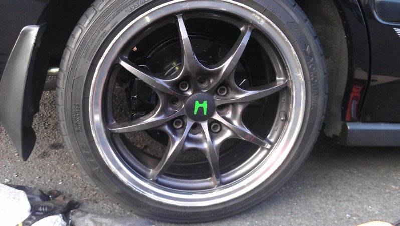

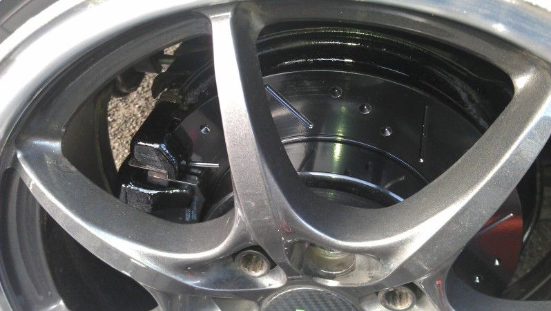

KiNK43 Posted March 24, 2012 Author Share Posted March 24, 2012 Link to comment Share on other sites More sharing options...
WilkesyMB6 Posted March 24, 2012 Share Posted March 24, 2012 Looks good but weird mate, if you know what i mean? Have you got any pics that are a bit further away? Do they look like drums now, as you cant see the disk as clear?Also how long do you think the disk will stay black? Link to comment Share on other sites More sharing options...
