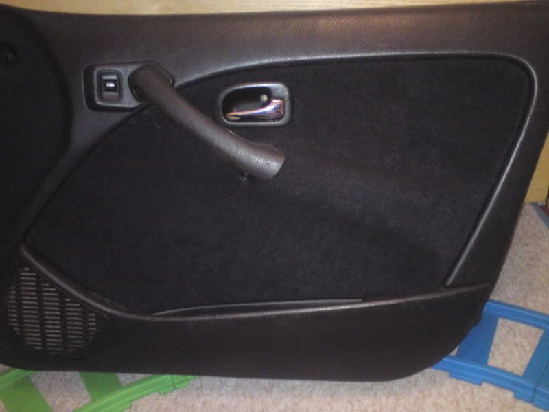

KiNK43 Posted January 8, 2011 Author Share Posted January 8, 2011 finally got round to starting retrim on doors.i baught the fabricc for this nearly a year ago but never have the time.johngreen.. inspired me to crack on with it..one doown, three to go.quite pleased with it. few little spots where the glue has come through but not noticable. will redo when the other three are done.cut where fabric overlaps is the hardest bit!ive used black fine fleece type material, looks very professional finish i think. Link to comment Share on other sites More sharing options...
johngreen537 Posted January 8, 2011 Share Posted January 8, 2011 Easy as pie aint it mate!Where did you put the cut? THrought the door handle opening? Cracking job! Link to comment Share on other sites More sharing options...

KiNK43 Posted January 8, 2011 Author Share Posted January 8, 2011 Yeah not too bad a job, I put a cut inline with the elbow rest? bulge in the door right through to the edge. Couldnt think of a better way to do it. Can just see it but ok. Next one tonite then! Funtimes! Link to comment Share on other sites More sharing options...

james Posted January 8, 2011 Share Posted January 8, 2011 how did you cut it to size did you lay the orignal on top and cut around it Link to comment Share on other sites More sharing options...
KiNK43 Posted January 8, 2011 Author Share Posted January 8, 2011 Cut it too big to start with. Glued center. Mask off edges and glued them. Flatblade screwdriver to tuck it in. Then when glue dried, used a scalpal round edges and handle holes etc. Link to comment Share on other sites More sharing options...

johngreen537 Posted January 8, 2011 Share Posted January 8, 2011 Cut it too big to start with. Glued center. Mask off edges and glued them. Flatblade screwdriver to tuck it in. Then when glue dried, used a scalpal round edges and handle holes etc.Did you use my how to mate, nice to see someone else has tried it Makes a hell of a difference over factory cloth don't it! Link to comment Share on other sites More sharing options...
KiNK43 Posted January 8, 2011 Author Share Posted January 8, 2011 Must admit I did have a butchers at your how to when you put it up. Very helpful thanks!Yeah much better than standard. Just waiting on correct boss for my momo wheel. Baught ek one by mistake and had to send back. So got no airbag or column surround on at min, looks a bit s**t to say the least. Gettin there though. Then a quick vac get rid of all the plaster dust from my foreigners. Sorted. Link to comment Share on other sites More sharing options...
