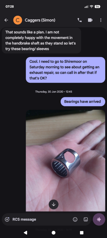

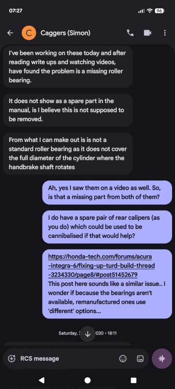

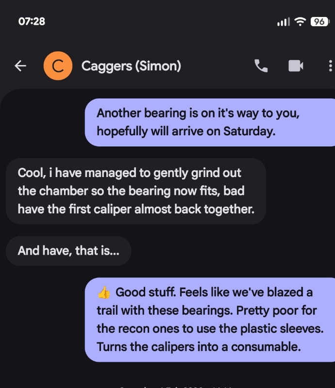

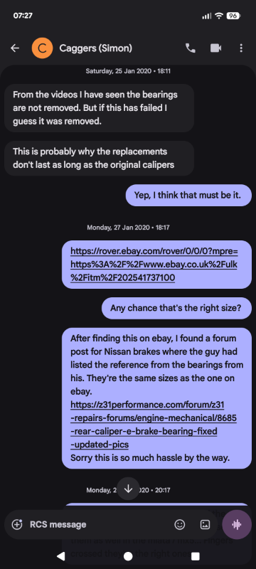

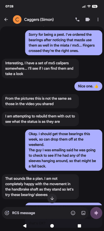

Actually, here's the sms chat about the whole thing...
How that helps. Let me know if you need any of the links in that chat
