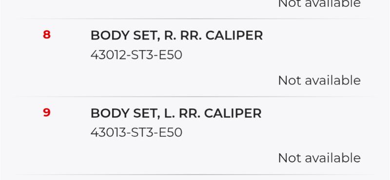

Now, honda don't seem to sell (or even list a part number) for the needle roller bearings, and trawling through the Internet seems to confirm this.
What I'm trying to find out is what is used when calipers are remanufactured - any chance that anyone knows?

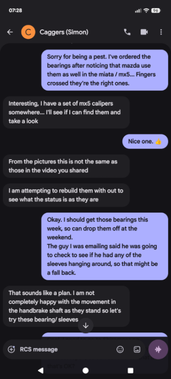

For anyone else in Internet land who needs needle roller bearings with a hole for honda brake caliper handbrake mechanisms, you need
7E-HKS BA1012 Needle Roller Bearing with Hole 15.875x20.638x19.05mm
I got mine from the seller named cardiff-deals
https://www.ebay.co.uk/itm/202541737100
Happy days again mate lol

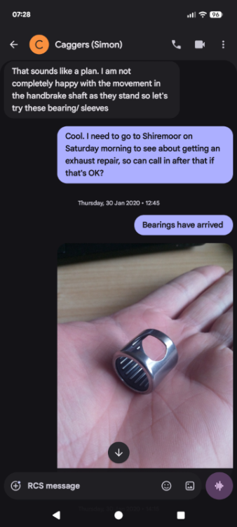

On 1/31/2020 at 12:05 AM, dr_broon said:
Arrived yesterday, dropped them off last night, and after some mild grinding of the caliper to clean up the chamber, it fitted like a glove applause.gif1
Massive props to @shebabby for pointing me in the right direction on ebay.

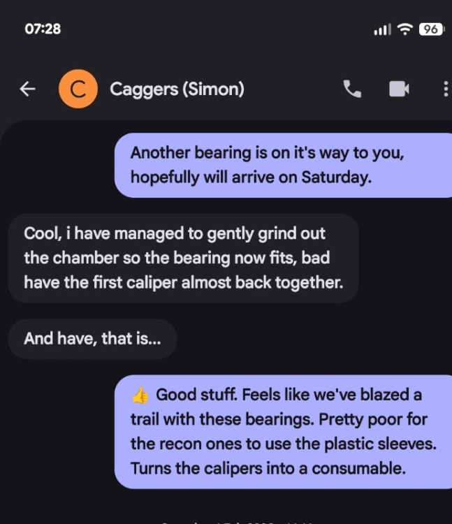

Hi there.  I don't know if I'm likely to get a reply on this old thread, but I've obtained and ruined several of these bearings trying to install them, and it would be helpful to find out how someone did this successfully before I go buying/making tools that might not be necessary.
I've cleaned up the bore with a brake cylinder hone followed by 2000 grit sandpaper.  Before that, I removed a couple of burrs with a Dremel.  Then I pushed the bearing with a c-clamp and a bronze bushing with an OD just a little smaller than the bearing OD.  The third try looks like it would be okay, but the cam shaft binds when I try to turn it.
Do you have any suggestions?
  • 0
Hi. I'm sorry buddy, I don't have (or remember) any more info other than what's on this thread.
Does the crz (assuming that's what they're for) share the same (or similar) calipers as the mb6 /MC2? These are the part numbers
I can confirm that they're still going strong though.
The only other bit of info I can share is the guy who did the work for me:
https://www.caggersparts.com/index.html
It's been a while since @shebabby was on the site, but tagged here just in case
