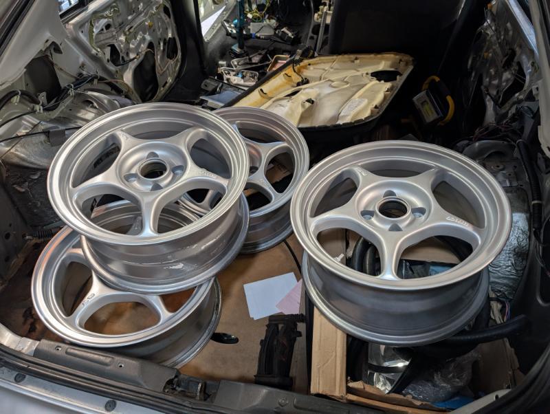

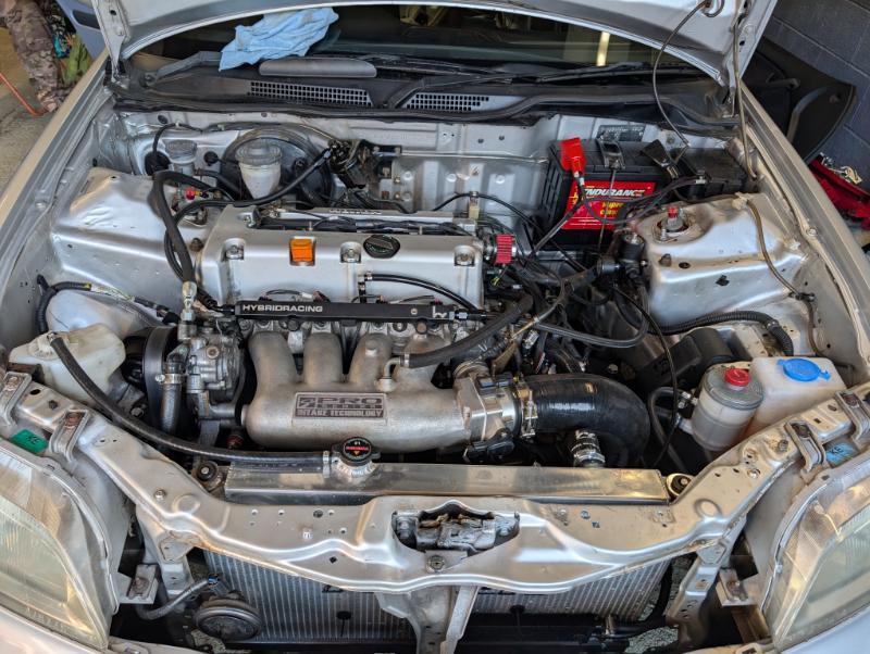

btjtaylor Posted September 29, 2025 Author Share Posted September 29, 2025 Been chipping away at jobs the last few weeks and should be ready to drive soon. Everything in the engine bay should be done now - had a quick tidy up any loose pipes/wires and made sure everything was bolted down securely. It's not a super tucked show car but I think it's neat and tidy enough for the type of build that it is. Plus everything is easily accessible for servicing! Fitted a small washer fluid bottle - £10 from Amazon so it's a bit cheap and cheerful but it connected straight onto the factory washer pump connector and lines! Removed the rear washer pipe as we've already removed the rear wiper. The Hybrid Racing cold air intake bolts into where the factory washer bottle sits so it had to go. Picked up a set of Enkei RP01 (15x7 ET35) wheels for a reasonable price (about the same as i'd pay for a set of Rotas or similar). Will get some tyres on them this week and see how they look on the car. The main thing is they fit fine over the MG ZS front callipers with plenty of room to spare. I wasn't sure they would initially as the ZS came on 16s, although admittedly with much less offset. They've been rattle canned by the previous owner but honestly he (or she) has really not done a bad job at all. Initially I was looking to change the colour but for now they will do as is, for now I'd rather spend money on getting the car working than cosmetics! 2 Quote Link to comment Share on other sites More sharing options...
dr_broon Posted September 30, 2025 Share Posted September 30, 2025 Those wheels look nice mate, should look good. Screen wash bottle doesn't look of place at all.. Handy to know. Do you think you'll get on the road before winter sets in (and the salt comes out)? 1 Quote Link to comment Share on other sites More sharing options...

Dave Posted October 2, 2025 Share Posted October 2, 2025 Wow, this is coming along nicely! Looks like that engine has been in there from the factory, really nice install that mate! Loving the wheels, think they'll look superb on it. What a cracking build to follow! 1 Quote Link to comment Share on other sites More sharing options...

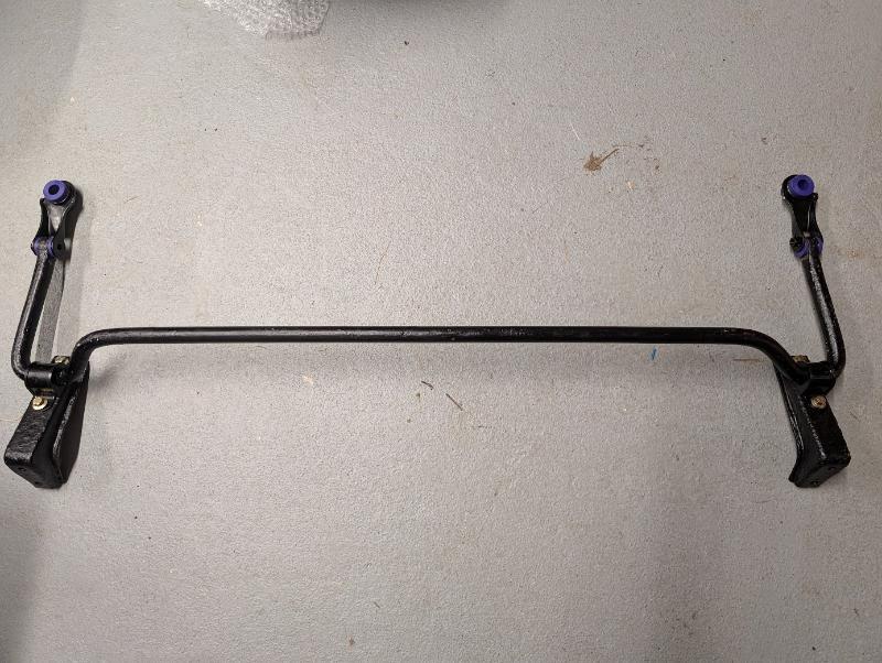

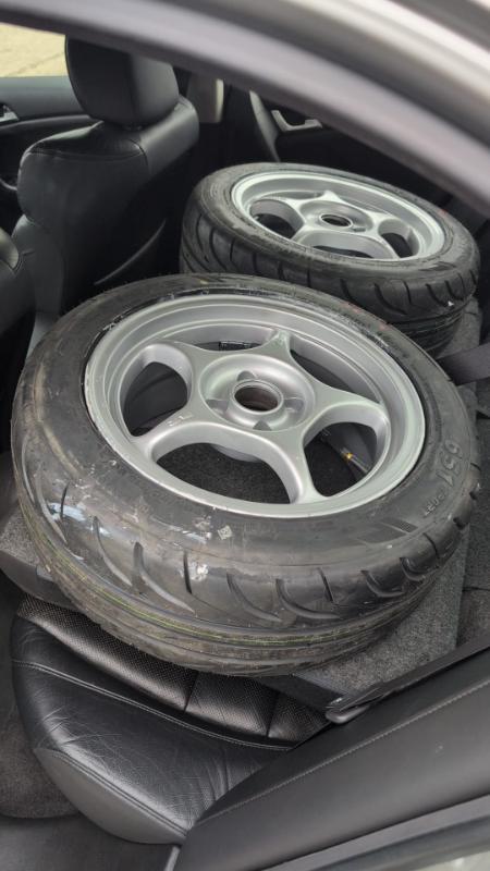

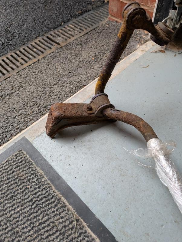

btjtaylor Posted October 8, 2025 Author Share Posted October 8, 2025 Bought a set of (very) budget semi-slick tyres "Accelera 651 Sport Xtra" from a company called Tire Streets that i'd seen advertised on various youtube channels. I don't have particularly high expectations as they were extremely cheap (£280 for a set of 4) but according to various internet comments/reviews they seem to be reasonable. I can always upgrade them in the future if needs be. The rubber seems soft which is a good start for a track tyre. Normally I don't like to order tyres separately to fitting (as usually the fitting cost removes any savings) but I couldnt find anything suitable supplied and fitted so I paid the local tyre place £15 a tyre for fitting and balancing which seemed reasonable. Look forward to getting them on the car soon... Finally got around to finishing restoring an MG ZS 180 rear anti roll bar I picked up from a friend a few months back. It was in pretty sorry condition but it seems like they are not sold new any more. Fortunately, you can still buy drop links, poly bushes, and all the bolts so it was just a case of stripping it down, removing the rust, painting it and replacing as much of the hardware as possible. The bushes were a real pain to install without a press but after a lot of farting around in the vice I got there eventually... For reference here's how it looked before (!) 2 Quote Link to comment Share on other sites More sharing options...
dan1 Posted October 8, 2025 Share Posted October 8, 2025 All looking good mate, those wheels should look great! The arb should defo help stiffen things up aswell. Doing stuff without a press is a right pita. I treated myself to one last christmas and it defo paid for itself when I did my polybushes haha 2 Quote Link to comment Share on other sites More sharing options...
dr_broon Posted October 9, 2025 Share Posted October 9, 2025 That arb was pretty crusty before ey? My old one was worse for wear as well, not quite that bad though. I guess they're pretty exposed to all the road grot Quote Link to comment Share on other sites More sharing options...

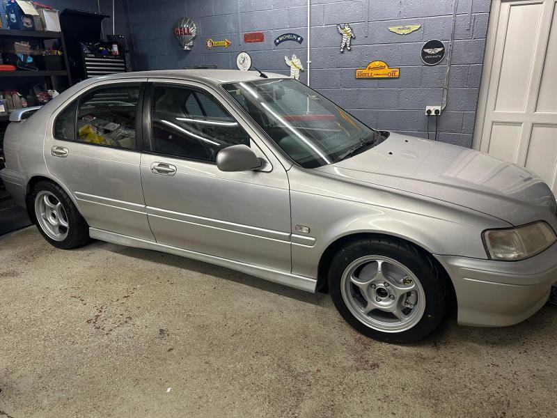

btjtaylor Posted October 9, 2025 Author Share Posted October 9, 2025 Looking good if I do say so myself! Headlights definitely letting the side down, need a good polish and coating. 3 Quote Link to comment Share on other sites More sharing options...
dan1 Posted October 10, 2025 Share Posted October 10, 2025 Looking great mate!! I can highly recommend this 2k clear spray for the headlights instead of an end sealer. https://www.marlowpaintsupplies.co.uk/2k-2-in-1-headligh-clearcoat-a-s?srsltid=AfmBOoo1LxQxl8VEhYvsmuG0kFjmCflsOD0QmbvwUwqEnJsCPrUhCWGO I tried a holts restoration kit but the supplied sealer was rubbish, didnt last a year. Sanded it all down again, used that clear and its looking the same after 2yrs 1 Quote Link to comment Share on other sites More sharing options...
