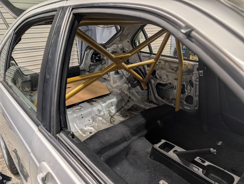

Bolt in half cage fitted today. Quite an awkward install as there's a lot of holes to drill and try to keep everything on centre but we got there eventually!
Very impressed with the welding and paintwork - definitely recommend JP Cages who supplied it

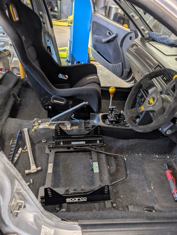

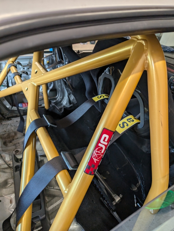

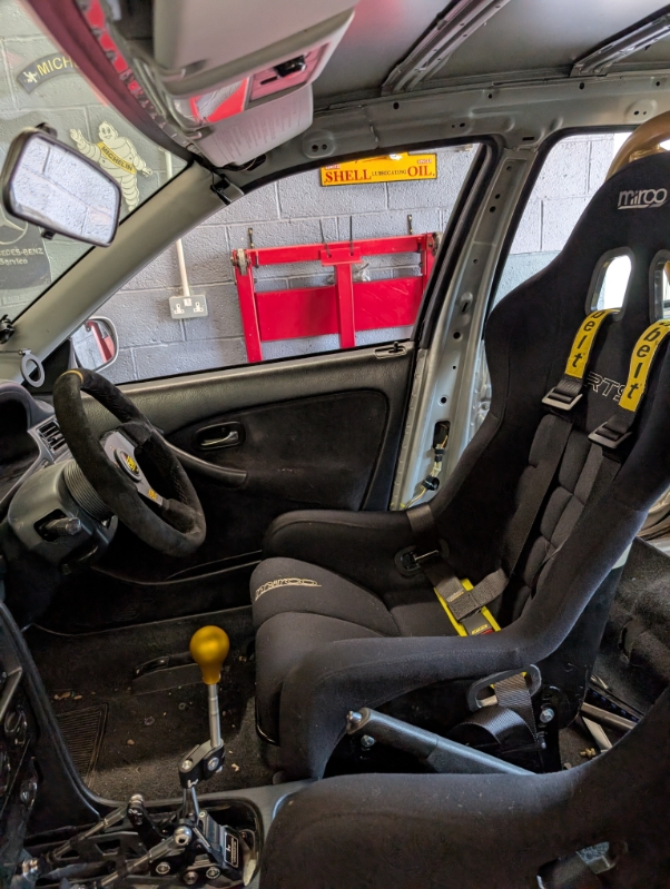

Spent a (very hot and sticky!) bank holiday in the garage fitting seats and harnesses
Thanks to a very helpful poster (above) I found out that the Planted USDM Accord 94-97 seat bases fit the bolt pattern of the MB chassis. Much easier than having to modify the factory seat or have something new fabricated.
I then fitted Sparco sliders and side mounts. I got away with only having to drill 1x extra hole in the seat base which by all accounts is a lot better than most manage! Without the sliders the job would've been much easier but i'm glad I persevered and fitted them as I wanted different people to be able to drive the car, and it's much easier to get in and out if you can slide the seat back.
The seats are Mirco RTS fibreglass buckets. I picked them up pretty cheap used as the FIA certification had expired on them (they came out of a competition rally car) but other than some general scuffs and scrapes they're in good nick, and totally suitable for track days. Much better than what I could've got new in the same price range.
Still lots of adjustments to make on the harnesses as I didn't really know what I was doing but at least it all fits!
Looks like a tidy job, and good to be able to keep them adjustable. Also look nice and low still - my Ep3 seats suit quite high with fixing them too the standard rails (though I'm used to them now, and tbh I'm close enough to the ground anyway 😁
Seats look spot on as well.
Yes - it's not bad really, i've definitely sat in much worse. The seat could possibly go a little lower but I will probably mess about with that once i've actually driven the thing in its current form (getting restless now 🤪). I can reach the controls comfortably, that'll do for now!
Without the sliders in it could go REALLY low. The sliders add a tiny bit of height but you also can't mount the seat at the low position at the front as the locking bar fouls on the seat and you can't adjust it.

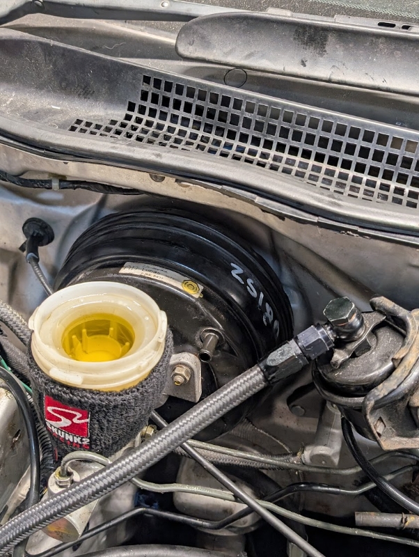

Finally finished the last piece of the brake upgrade today.
MB6 master cylinder and ZS180 brake booster (seems to be the same as the MB6 one but I found a good deal on a ZS180 unit. One of those parts that people are asking stupid money on ebay for but if you put in the time on FB groups etc you can get one for a more reasonable price.)
Unfortunately the MB6 master cylinder has the brake line fitting slightly further away from the prop valve than the MB2 does so I had to remove the line from the car and bend it in the vice to straighten it out which resulted in the below. I'm not particularly proud of  myself and I should probably remake it properly at some point or maybe get an MB6 pre-bent line but it does work!
