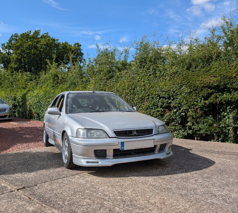

btjtaylor Posted June 28 Author Share Posted June 28 Managed to get the car out into the sunshine today for the first time since October! I set up the ride height as best I could following some online guides (trying to give maximum "bump" travel) and adjusted the camber using a fairly cheap magnetic gauge, which wasn't the easiest thing to read but did the job, -1.75 degrees at the rear and -2.75 degrees at the front which seems to be a good starting point according to people on the internet who are much cleverer than me! Visually it looks about right comparing to other builds i've seen at least. Next time i'll adjust the front and rear toe using strings to try and at least get it somewhat in the ballpark. After replacing the steering rack the front wheels somewhat resemble this GIF currently! 1 1 Quote Link to comment Share on other sites More sharing options...

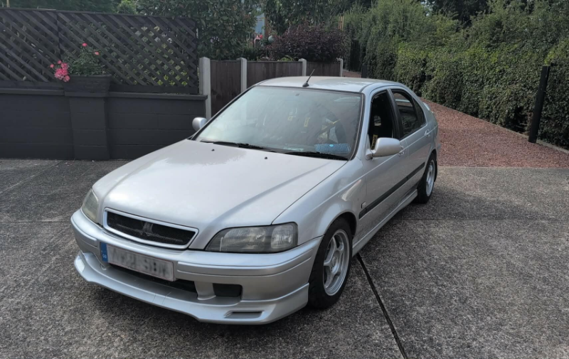

btjtaylor Posted July 5 Author Share Posted July 5 My first time trying a string alignment at home - no expense spared alignment rig built out of 2x curtain poles, 2x builders chalk lines, 4x axle stands, and some rubble bags with white grease in between to act as turnplates! 🤣 It did seem to do the job though. At the very least, it means my tyres won't get shredded on the way to get an MOT and then on any test drives. Stance looking bang on now! I went to go for a VERY quick test drive and quickly found I couldnt select 2/4/6 gear .. oops. It was working until I swapped the shifter so I think it's nothing serious just a shifter cable adjustment issue. One of these days it will leave the driveway!! 2 Quote Link to comment Share on other sites More sharing options...
