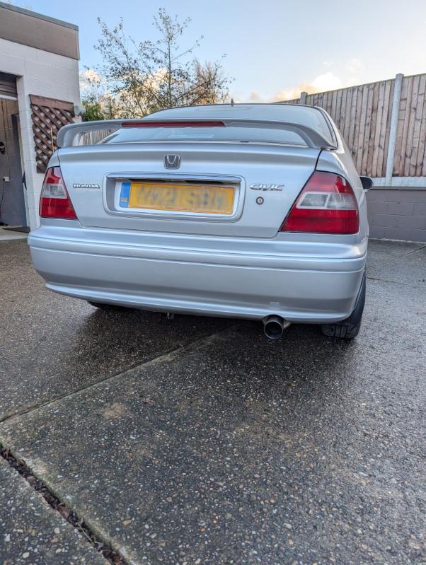

btjtaylor Posted November 23, 2025 Author Share Posted November 23, 2025 Car is finally back from the exhaust shop. The tailpipe is pretty subtle looking but it sounds pretty angry (in a good way!) Not the best pics as was on axle stands today but it's got a 200 cell sports cat then 3" all the way through with a centre res and rear box. It's totally overkill for N/A but I wanted to prepare for all possible eventualities! Worked on a few other annoying issues. The throttle body was sticking open slightly but that seemed to be down to a rubber boot on the throttle cable getting jammed in the throttle body wheel. Secured that on properly and now it seems to be behaving itself. No signs of any check engine lights related to O2 sensor, I think my suspicion about it just being because it was at the end of the pipe was correct. Replaced the totally rotten and corroded bleed nipples on the rear drums and managed to do a full bleed of the brake system, that's working a lot better now. Battled with bleeding the clutch all day. The master cylinder looked like it was weeping so I fitted a new one but this didnt help at all, despite fluid coming through it still feels spongy. Next time im going to try a "reverse bleed" pushing fluid back up from the slave cylinder end... to be continued 1 Quote Link to comment Share on other sites More sharing options...
