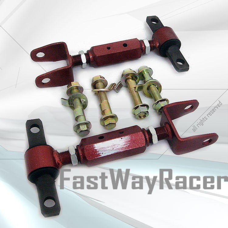

johngreen537 Posted March 21, 2011 Author Share Posted March 21, 2011 Rear mate. It's not as much adjustment as you can get with 'proper' arms, but...Basically, where the two bolts go from the camber arms (upper arms) to the chassis, add a spacer between the bolt and the chassis. When you tighten it up, it's got the spacer between the arm and chassis, so pushes the wheel outward a little. Never tried it (or even looked) at how the EP3 is set up, but imagine it's the same!I thought it was a quite well known little trick Fronts. Well that's a whole different story... The adjusters you can buy, are bolts with a lobe on, so I'm assuming the lobes just upsh the upper mount outward a little. Link to comment Share on other sites More sharing options...
jalesi2001 Posted March 21, 2011 Share Posted March 21, 2011 Yeah thats why I asked mate, with the way the camber arms are fitted to the rear of an EP3, the bolts go up into the chassis, so fitting a spacing washer wouldnt really do anything that you would notice I rekon. If they went in horizontally, then I could see it working.. Link to comment Share on other sites More sharing options...
johngreen537 Posted March 23, 2011 Author Share Posted March 23, 2011 I'll be buying arms then Not had chance to get under it for a proper look yet though...Still it's at -1.5 degress at the min, and thats a mojor inprovement, so when i get round to dropping it a bit, that should be more than enough Link to comment Share on other sites More sharing options...
