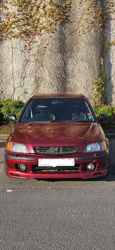

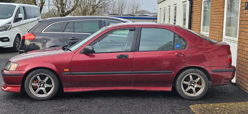

dan1 Posted April 28, 2024 Author Share Posted April 28, 2024 Whoops, hope these work haha. Got round to fitting most the parts - also fitted a k-tuned rep short shifter with a stainless weighted knob which makes the car feel so nice to drive - will get a photo soon. Me and my wife have also had a baby so time and money to work on the car are in short supply!! Next steps are to get the interior sorted - really want to fix the headliner, and seeing Kaleverada's thread has me inspired for the pillars! Also really want to strip out the back, tint the windows & fit bucket seats... 3 Quote Link to comment Share on other sites More sharing options...
dr_broon Posted April 28, 2024 Share Posted April 28, 2024 Looking sweet, and congrats on the baby mate 😎 1 Quote Link to comment Share on other sites More sharing options...
dan1 Posted May 1, 2024 Author Share Posted May 1, 2024 On 4/28/2024 at 7:53 PM, dr_broon said: Looking sweet, and congrats on the baby mate 😎 Thank you mate. So happy with how the car is, looking forward to some decent weather to enjoy it in! 1 Quote Link to comment Share on other sites More sharing options...
Dave Posted May 3, 2024 Share Posted May 3, 2024 Man she is looking spot on mate! Sitting really nice on those wheels too. Stunning! Quote Link to comment Share on other sites More sharing options...

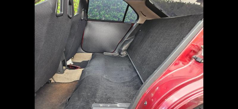

dan1 Posted May 21, 2025 Author Share Posted May 21, 2025 Interior shot also of the seats gone.. fitted a blanking panel instead to help bring cabin noise down abit!! Quote Link to comment Share on other sites More sharing options...

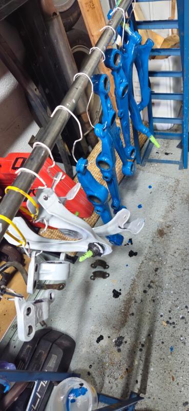

dan1 Posted May 23, 2025 Author Share Posted May 23, 2025 Cheers mate, will be glad when I've got the painting finished.. currently the bane of life haha. Process so far has been - - wire wheel strip on grinder - soak in deox-c - wash (kitchen sink while wife is out) - coats of hydrate 80 - epoxy primer - top coat Now totally sick of sanding and painting haha. Forgot to mention I've also got a 24mm front arb and 18mm rear arb to fit, along with a modified rear subframe brace for a eg. Excited to get all this fitted and wrapped up 1 Quote Link to comment Share on other sites More sharing options...
dr_broon Posted May 24, 2025 Share Posted May 24, 2025 You've been a busy boy, love the use of the sink while the boss is out. 😁 those bits are looking good. Quote Link to comment Share on other sites More sharing options...
