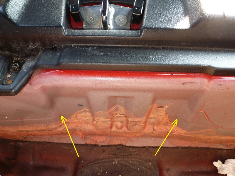

Spoke too soon !
After a night of frost and the front end up on ramps, the water was back in the drivers side rear wing.
Looks like the change of angle the cars sitting at had exposed another area of bad seal.
So, as I have only partially sealed the rear boot window, looks like I will have to do more.
As I had put the spare wheel back in, decided to check if any water under there. And there was ….
Traced where this water was coming from and it was entering from the seam where I,ve shown on the fist pic.
As couldn't tell from inside if there was a hidden closed panel where the water was sitting, decided to remove the rear bumper and the second pic shows that there is no exterior seam or hidden closed panel in that area.
The only closed panel where water could sit and then enter the boot is the panel below the boot lock shown in the 3rd pic.
Bit of a mystery this - shone a torch around the boot lock and no sign of water sitting there, but cant see much in there and there were signs of mud, probably from a previous wash of the boot/trim.
One thing though, this closed panel connects to the closed panel running up to the rear windows so.....
I could just seal that seam inside the boot but it worries me that the water could still be sitting behind it
