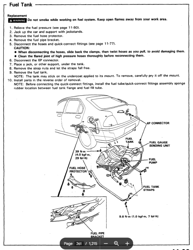

0 KiNK43 Posted April 3, 2020 Share Posted April 3, 2020 The fuel pump can only be accessed from under the car, have to lower the tank. what your looking at is the fuel gauge sender. Quote Link to comment Share on other sites More sharing options...

0 Guest Michael Posted April 3, 2020 Share Posted April 3, 2020 7 hours ago, KiNK43 said: The fuel pump can only be accessed from under the car, have to lower the tank. what your looking at is the fuel gauge sender. How would i go about replacing it then? Quote Link to comment Share on other sites More sharing options...
0 Dave Posted April 3, 2020 Share Posted April 3, 2020 1 hour ago, Guest Michael said: How would i go about replacing it then? From what I remember I think you need to drop the tank to get the pump out, no other access to it I'm afraid. I would check the fuel pump relays and also any fuses that are to do with the fuel side of things, and also that cutt off switch in the footwell/bottom of A-pillar (least I think that's where it was, been that long! Was there on my honda civic TypeR) Quote Link to comment Share on other sites More sharing options...
0 KiNK43 Posted April 4, 2020 Share Posted April 4, 2020 The inertia switch is behind the centre console plastic driver's side. But yes you'd be best checking you have power going to the pump before going to do the pump. It's a pain on your own trying to remove the fuel tank. Quote Link to comment Share on other sites More sharing options...

0 Psilos Posted May 10 Share Posted May 10 I am facing some problems with the fuel gauge. When it shows 1/4 I ran out of fuel. When it's full it shows 4/5 not full. I checked the gauge sender measure it with multimeter and it shows 6.5Ω full, 114Ω empty. The manual says 2-5 full and 105-110 empty. Ok i don't think it's a problem. I want to check the fuel pump. Where is it located? Isn't it under the back seats?? Do I really need to get the fuel tank out? Quote Link to comment Share on other sites More sharing options...
0 dr_broon Posted May 16 Share Posted May 16 I'm sure it's a tank out job.. At least on the aerodeck Quote Link to comment Share on other sites More sharing options...
0 btjtaylor Posted May 19 Share Posted May 19 (edited) Fuel sender there's an access hatch under the back seat so it might be worth having a look there to see if something obvious is wrong with it. Pump is on the other side and tank out (it's not as bad a job as it sounds as long as you can get the car high enough). I replaced mine with a Walbro 255 (The warning about not smoking while working on the fuel system is rather 90s isn't it!) Edited May 19 by btjtaylor 1 Quote Link to comment Share on other sites More sharing options...
