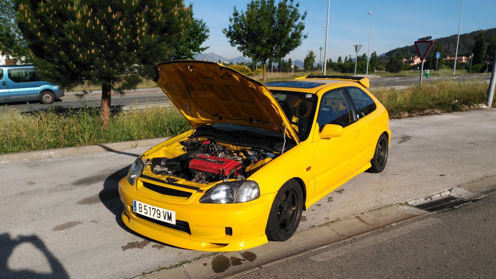

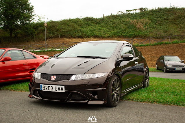

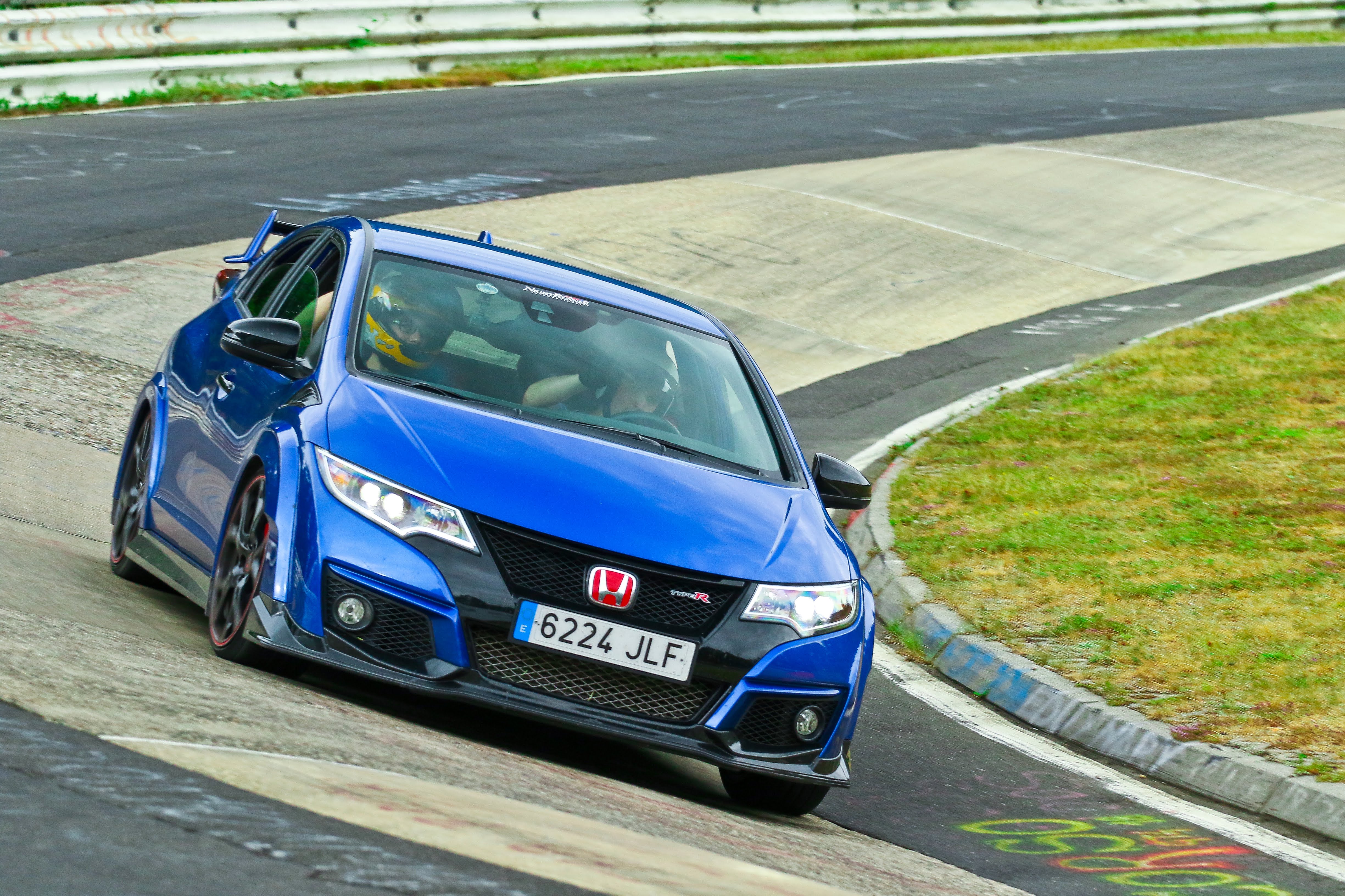

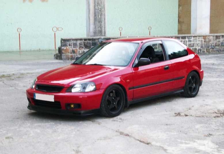

I started with a peugeot 205, but after that car I've had various civics. My very first one was a ´99 Civic EK daily driven when I was student. I got it for 8 years and ended up respraying and B-swaping. In between I had a EG5 (no pics) only for some weeks, it was really rusted so I break it and sold parts. At this point, I bought the MB3 I will show on this thread. The EK was really intense driving but wanted something different, fast and more confortable, so I got chance to purchase a '16 Civic Type R and ended up selling EK. I owned it for two years, drove both summers to the Nurburgring and sold it to buy a house. I had the chance to own a '10 K24/20 FN2, an awesome car, but after the FK2 I was a bit upset... so I sold it after only 4 months and ended up with a barn find '99 EK1 really cheap I have restored after 4 years been used only in gravel paths(I will open a thread for this one).

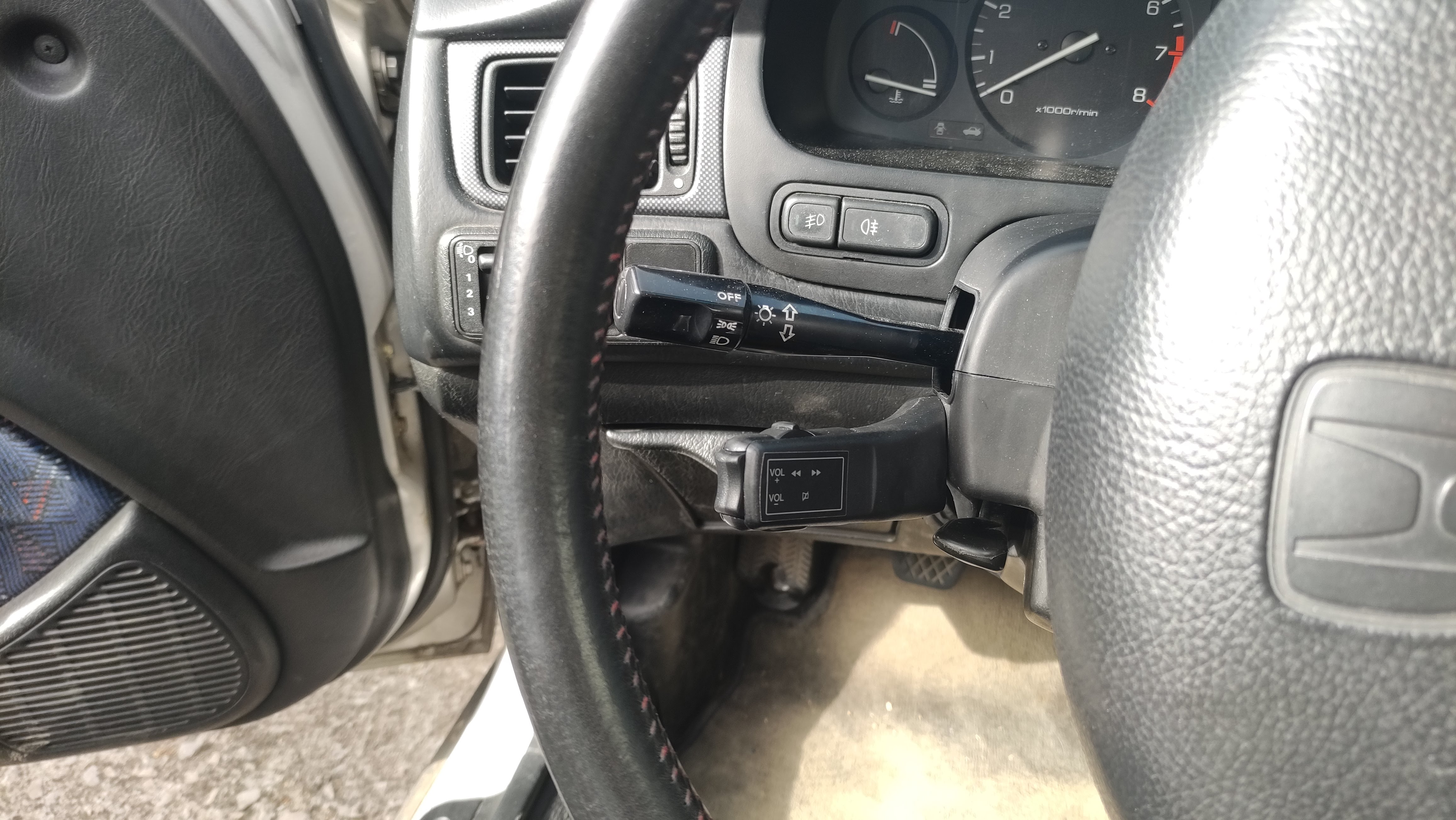

The screen I bought is from amazon (chinese) it has good response... in some cases freezes, but I think its my fault (I have attached a 16GB pendrive full, 2500 songs... and needs time to read :mrgreen:) I think I havent attached a very important pic. I was planing on installing steering wheel controls, I need to research for more info (the airbag ring must be changed and the steering rack doesnt fit fn/fk wheels... I think). Anyway, I installed this to have a similar experience controling the screen. I didnt move the warning/fog/clock because it was more work modifiying... I wasnt to sure it would end up well and you only will win 4-5 cm taller, it wont be really significant.
